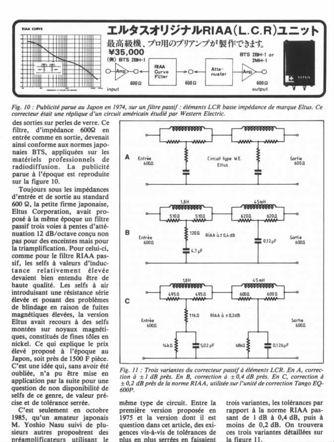

For a long time I've been tinkering with this type of RIAA correction for a tube preamp.
Since the LCR modules are again available I am looking for some input from others on how to best implement this.
More precisely, how to do this without using any stepdown xformers if possible.

I have been really struggeling on this myself. I am not per se against using transformers, but with most "normal" valves (eg. 6S45-PE) you end up wedging the RIAA between two Transformers, the stepdown one probably having to be used in parallel feed as well.
This means two transformers add their rolloff, which even with something like a pair of Stevens & Billington TX-103 per channel for matching the RIAA (and yes, I did consider that and even tried something similar clipleaded with an RC RIAA just to ***** the impact of the Transformers) means you have over 2db more loss at 10Hz (and less consequentially but audible) 100KHz than without the transformers.
As few transformers offer relaibly such wide bandwidth at the required levels (such transformers also cost less of course) things may be even worse. I like transformers but not just for their own sake.
One option that frees you totally from the question how to drive a low impedance LCR RIAA EQ is to make a high impedance one. Yet given the problems of making the relative low value inductors for the 600 Ohm Impedance RIAA I suspect a 10k LCR RIAA may prove very difficult to make reliably.
Secondly, you could of course simply use any old Valve stage with suitable gain, take a small value coupling cap and use a solid state unity gain buffer to drive the pubishing (for valves and even most Op-Amp's) 600R Load of the RIAA, but of course, that is "cheating" (I'd say inspired and competent engineering, but I know it's cheating in the end.
I ended up persuing a very different Tack. Using suitably high Gm Pentodes (E810F - 50mA/V) you get plenty of gain even into a 600 Ohm load and even better, as the Output impedance of the Pentode Valve stage is very high you can at least partially compensate the use of a much smaller value than conventionally required coupling capacitor. I have tried as small values as 2.2uF in my circuit.
The circuit I'm talking of is of course this one:
Phonostage Circuit
Total gain of this Phonostage with a S&B TX-103 wired for 26db stepup is over 66db, output impedance is under 2k, just fine for a TVC with 6db stepup, which in total gives 72db gain.
With a typhical 0.25mV MC pickup this gives around 1V RMS out with around 14db headroom on top of this (the Max. Headroom on LP is around 14db above the reference 5cm/S at 300Hz), or up to 5V RMS on the highest peaks. Just right to feed an Ultracurve Digital EQ or low gain DHT Amplifiers.... ;-)
Assembled the whole thing with S&B TX-103 MC Stepups and Prototypes of the S&B RIAA-600 EQ Modules looks like this:
Phonostage piccie
Using the same basic principle of driving the RIAA from a very high source impedance I could think of using three or four paralleled 2SK170 J-Fets in Cascode with a valve (say a 6N30?) to give 60 - 80/V into the 600R RIAA. This will give a gain of the first stage of around 36 or 48 aka 31 and 33db respectively. The output could then be the other halve of the 6N30 again, very low impedance to drive a TCV or the like well. Overall gain of such a circuit without MC Stepup could be around 33 to 35db due to the low gain of the second valve.
Of course, if you liked you could use another 3 - 4 2SK170 Cascode in the second stage with 600 Ohm anode load for low output impedance. Then you have a total gain of 42 - 46db without MC Stepup and up to 72db with a TX103....
Maybe all this gives you some ideas?

Re: MISSING LINK.
Actually, there are plenty more. My HDD holds over a dozend RLC or RL equalised Phonostages....
To save me excessive typing I shall quote here from the Application note posted here:
S&B EQ-600 RIAA Module Application Notes
"The EQ-600 is designed to operate in a 600 Ohm matched impedance system, as provided in many broadcast and similar applications. Either the load provided to the RIAA Module must be 600 Ohm in which case the drive impedance is immaterial and the RIAA Module presents the driving circuit with a frequency independent 600 Ohm Load (+/-5% or closer tolerance) OR the impedance of the source (drive impedance) must be very accurately 600 Ohm in which case the load impedance is immaterial."
"The specifics of the amplification stages are really up to the designer using the RIAA Module, the degree of freedom in choice of topology, active device and so on is huge and even a most scant coverage would require a long article. The RIAA circuit will in any case of application cause around 20db attenuation at 1KHz. Possibilities include Operational Amplifiers set to give 30db gain, Mu-Follower stages using a 6SL7 or similar valves for the gain parts and suitable follower devices and many other Valve, hybrid, discrete solid state or monolithic integrated solutions. As a rule the output of the first amplification stage should either be of a matched impedance of 600 Ohm or of low source impedance and able to drive a 600 Ohm load to significant level."
"Typically, to maximise overload margins and such one would have for a typical "moving magnet" type phono stage Amplification stages with around equal gain of around 30db each and suitable output impedance's. In such a case a phono stage using the RIAA Module would have a total gain of around 40db allowing an IEC sensitivity of 5mV for Phono."
"If a TX103 is added ahead of the phono stage to match MC Cartridges the IEC sensitivity becomes 1mV, 0.5mV and 0.25mV respectively for the 1:5, 1:10 and 1:20 step-up ratio. If a TX-102 based passive controller is used following the phono stage and if the output stage gainblock offers a compatible output impedance the TX-102 can be connected in 6db "passive gain" mode, giving IEC sensitivities of 0.5mV, 0.25mV and 0.12mV for the complete phono stage."
"Other gain schemes are possible but will result in reduced overload margins."
I hope this clarifies.
Sayonara
PS, driving a 600 Ohm load from an infinite source impedance is no issue, the load simply is driven in pure current mode. Equally a Pentode has no problems at all to lineary drive a dead short at all (the same cannot be said of triodes though).

Re: Re: MISSING LINK.
On second thought, I always believed the best way to enrich oneself is to freely give away what one has, so I have uploaded/am uploading a library of LR/LCR equalised Phonostages for the general entertainment of the distingue audience....
All schematics are deposited here:
LR/LRC RIAA EQ Schematics
Note that some schematics (especially those from the Sakuma inspired school) do not offer an overly accurate RIAA Response. How relevant this is everyone must decide for themselves.
Sayonara

I can confirm the findings of the illustrious Kuei Yang Wang on the sound quality of LCR RIAA stages.
I performed the following experiment. The reference preamp was a modified Loesch style preamp. This consists of an jfet/417a cascode input stage, split passive RC, 6GK5, the rest of the passive RIAA, into a 5687 line stage. This is similar to the Toccata II mentioned by KYW.
I bought myself a canned LCR network which appears to be a knock off of the Tango EQ-600P for Korea. You can see it here:
http://www.allnicaudio.co.kr/lcr-unit.html
Being anxious to listen to the thing, I slapped together a very
crude solid state test bed. I grabbed an INA103 and set it up
for 55db gain. This had trouble driving the 600 ohm impedance of the LCR network, so I ran it into a 4:1 step down transformer and then t the LCR network. This was then fed directly to the 5687 line stage. This set up was a bit short on gain and another step up after the LCR network or another gain stage is probably adviseable. Still it provided a quick glimpse into the sound of an LCR preamp.
The results, at least to me, were a bit shocking. The INA103/LCR phono stage was much better than the jfet/417/6gk5 stage. It captured the tone and natural decay of instruments in a way I have never heard before.
So I'm in the process of building up a tube version. Here's my current thinking:
MC transformer - 6C45 transformer loaded (4:1) - LCR- step up transformer (1:4) - 6C45 (exact config undecided).
---Gary
---Gary
