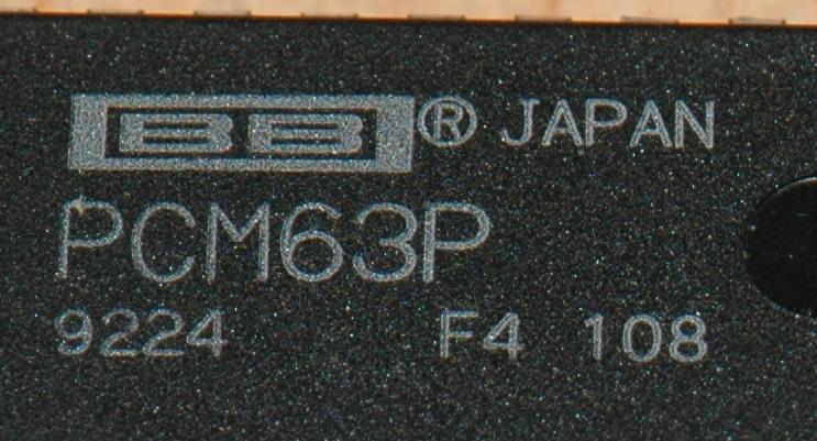

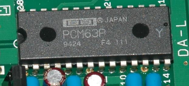

To be fair, I post here a original Y chip from a Yamaha set.
Look carefully on the font type, relative size, position, ink thickness, ink color, text relative position etc... I find that the picture in Post #5 still have many differences from the chip I have in the Yamaha set.
Everyone should have their own judgement.

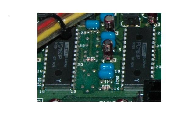

Spencer,
Also to be fair: Please look at this picture (attachment): It has been also taken from some Yamaha Digital device.
As one can see, there are 2x PCM63P-Y inside. For me, they does look like a'af's picture - I mean the one in his Post #5 above. Isn't it?
Greetings,
IJ.

IJ,
Your Yamaha chip looks very similar to mine (even the pic is very small).
There are many points that I do not like for the pic in post #5:
1. Japan, the J is different font, top do not have "-".
2. The "3" for the original is with a centre line at the middle. The one on Post #5 is with smaller circle on the top of "3".
3. The "6"and "9"is also different a bit on the tail ending.
4. The "Y"mark is using same type of ink. Very unlikely.
5. The "BB" in the BOX also not aligned to the centre. The gap of the BB on top and bottom is not evenly positioned.
6. The font and ink is too thick, I never see that in all my Japan chips (over 100 pcs that I have sold).
7. The surface (finishing) of the chip is rough a bit on top for original part, it is due to molding. For fake part, normally the surface is very smooth.
8. Due to rough surface, the original part with the marking is also rough when a high resolution picture is taken.
9. One more thing, most of Japan part is with one mold number "48"on the bottom, there are other two numbers but quite rare.
Please examine carefully and you will see what I mean by the ink color, font, text, texture, thickness etc... We do not need a expert here but most of the fake marking is not done too well. If they can do so well, they should go and print Money!
Sorry, when I first look at the pic in post #5, I cannot accept the part is original part, just too many questionable differences.
Spencer
