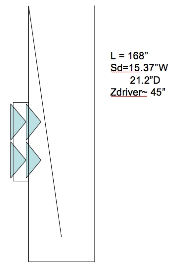

Okay, I think i'm sold on trying out some horns.
Lemme see if I got this straight though. Attached are two sketches, approximately to scale. I'm looking at them as my two options- option 1: make 4 of the 2 driver enclosure; option 2: make 2 of the 4 driver enclosure. I'd still rather not do clamshells, so i was hoping to load the drivers as shown. Does that work, or am i stuck doing clamshells?
I have to mount the drivers pretty far down to fit them in. Is that okay?

Greets!
Yes, you can do it this way, though due to the greater air 'spring' it's not quite as efficient.
I haven't drawn it out to scale, but normally there's more driver mounting space available on its side, though as long as the acoustic center (zdriver) isn't below L*0.416 it should be fine, just understand as the cluster moves down the pipe, so goes efficiency as it smooths out over a wider BW, which you don't need AFAIK.
If MDF, brace it well, running long boards along its length like done in these tapped horns (pipe horn variant), which is another option, though not nearly as easy to design: http://www.diyaudio.com/forums/showthread.php?postid=1366329#post1366329

AH HAH! I found why there's a disconnect. I think the formula for Sm on the BiB how-to-build page is missing a factor of 2! Boy, i thought I was going mad here. Now I'm on board with your dimensions for a single isobaric pair.
However, I think there's still a disconnect concerning using 4 drivers. I was planning on using them in parallel like this:
In this case I think that Vas is halved for each pair, and then since they are in parallel, the effective Vas is the sum of each of the pair's Vas, so you get back to ground zero: Vas/2+Vas/2=Vas.
Effective Vas = 5.54 cu ft
Vb = 20*5.54*0.375^1.25 = 32.54 ft^3
Sm = 2*32.54*1728/168 = 669 in^2
I think what you were thinking i was going to do was load 2 pairs of isobaric driver in series like this:
In that case, i agree with you that Vas would be reduced by a factor of 4.
Effective Vas = 1.386
Vb = 20*1.386*0.375^1.25 = 8.14 ft^3
Sm = 2*8.14*1728/168 = 167 in^2

Phew... hopefully i got this right that time. My head was about to explode with confusion.
OKay. i think that's cleared up now. I think...
Now, when comparing 4 horns with a single pair, versus 2 horns with 2 pairs in parallel. I don't see why there would be a difference in loudness.
