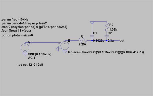

May I present a problem which should lead us to some basic RC-treatments?
Beneath is a riaa network(, fed by an ideal sine wave and inversed and 'gained' by an ideal inverter/amplifier.
A distortion measurement as displayed gives me a THD of 3.56%!
This method is given by Klaus (KSTR here) and gives reasonable numbers for a bunch of well documented circuits I tried.
As I think, that an 'ideal' phono pre shouldn't distort that much, there should be mistakes in this setup.
Which?
Rüdiger

A reported "problem", see
http://www.diyaudio.com/forums/showthread.php?postid=1246419#post1246419
And the user manual reads:
"The transfer function of this circuit element is specified by its Laplace transform. The Laplace transform must be a function of s. The frequency response at frequency f is found by substituting s with sqrt(-1)*2*pi*f. The time-domain behavior is found from the impulse response, which is found from the Fourier transform of the frequency-domain response. LTspice must guess an appropriate frequency range and resolution. The response must drop at high frequencies or an error is reported. It is recommended that the LTspice first be allowed to make a guess at this and then check the accuracy by reducing reltol or explicitly setting nfft and window. The reciprocal of the value of window is the frequency resolution. The value of nfft times this resolution is the highest frequency considered."
In reality (within the simming context), you don't have any distortion in the time domain, because both the laplace and the passive components are LTI (linear time-invariant). One can model nonlinear caps and resistors, though.
- Klaus

Hi Klaus,
thanks for your answer.
I have to admit, though, that I'm completly lost here.
Are you saying that I shouldn't get the THD-numbers I quoted? Or that I should ignore them? Then the word 'problem' shouldn't go with quotes because any analog filter circuits can't easily be tweaked.
thanks,
Rüdiger

Rüdiger,
Yes, you should get a straight zero for THD, because all elements are linear with regard to voltage and current. More precisly, you get the generator's intrinsic distortion multiplied with gain error at the harmonic frequencies. Say you input is 1kHz with a -90dB H2 component and your frequency response error is -1dB at 1kHz -3dB at 2kHz, H2 would come out as -92dB. But the generator distortion is really low, <= -160dB when using a small max timestep.
The errors you see come from the problems of doing the Laplace transform in the time domain, in LTSpice. Seems that one can't use it at all or has to know all the guru tweaks to get reasonable results (I don't).
Dad also raised a point... so try that first, let it run for like 20 cycles and then .four the last ot these (which it does by default).
- Klaus

Well, ok, seems I should read the error log as such as well...
"Frequency response of Laplace device "E1" does not roll-off fast enoughLaplace source: E1
WARNING: This Laplace expression needs an additional delay of 23.2µs to not violate causality.
Freq Domain: peak @ 0Hz BW=0Hz cutoff @ 0Hz
resolution: 250Hz nfft=16384
Time Domain: window=0.00196045s resolution: 2.44141e-007s
Second Compression Ratio=422.632
I altered the tran command to
.tran 0 {10*(ncycles*period)} 0 {pi/3.14*period/2e3}
this gives me a thd of .055%.
With
.tran 0 {20*(ncycles*period)} 0 {pi/3.14*period/2e3}
I get 0.022%.
The command
.tran 0 {100*(ncycles*period)} {99*(ncycles*period)} {pi/3.14*period/2e3}
gives .000134%
the same as
.tran 0 {100*(ncycles*period)} 0 {pi/3.14*period/2e3} to check if the simulator really choses the last cycle(s).
So, if one has the time (ran ~ 10minutes on my 2.4 GHz (or the like) PC it is at least usable to see if your circuit develops issues with one's RC- network.
Thanks!
Rüdiger

Not directly from the program... but you can .step the test frequency and past the output from the error log into a little spreadsheet that can plot whatever you like.aparatusonitus said:Can LTSwCAD plot THD vs freq., and how to do that if it can?
I did similar similar stuff (stepping a voltage in the example) and you can make nice plots of distortion vs. xyz.
- Klaus
