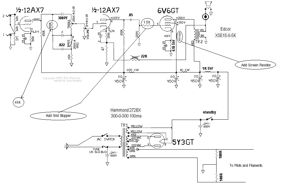

I modded one of the above schematics to reflect exactly what values are in the amp used in my posted clips.
Note extra filter cap, tone stack value changes, grid stopper and screen resistor, 6.3V virtual CT, NFB resistor value change and standby switch.
The results are a simple 4-5W amp that really kicks, yet at idle you can not even tell its on.
I have hundreds of hours on this exact setup and would say it is pretty reliable and even better yet, sounds incredible. I am driving a Jensen Neo 12"/100w 98.8db speaker.

Hello, toob noob here.
Why do you need the virtual ct for the heaters?
I have the case and transformers from a Bogen CHB-35a. The power transformer has 180vac with no ct and a 6.3vac winding with a ct. If i used SS rectification could i use these transformers for one of these small amps? What would i have to change in the power supply schematic here:
http://www.schematicheaven.com/hifiamps/bogen_chb35a.pdf
With full-wave rectification, the 180 volts will give you about 250volts, about 100 volts short of where the champ usually operates. It would work, but the power output would be greatly reduced.
The power supply as it is, is a but high, but a resitor could bring it down to about 350 volts for the champ circuit.
I am wondering: you have a push-pull amp with the Bogen, what about tweaking it for guitar use? A few changes here and there would make it a pretty decent guitar amp.
The virtual ground for heaters keeps the heater wires close to ground potential reducing the AC noise they induce. A center tap on the heater coil is best but the resistors work well too. Sometimes the resistors are replaced with a pot to adjust the hum rejection.
