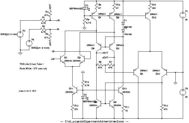

Just for reference. :)
This is not a complete schematic, the buffers are missing etc. But it gives you a good idea of what I am going to do.
This is also not the current version (it is actually one of my first simulation attempts) , it is just representative...
