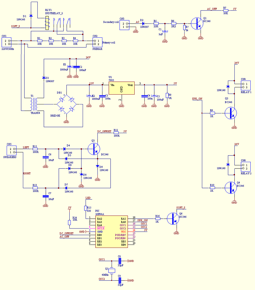

Loudspeaker Protector, my version
As there are many people interested in loudspeaker protection circuit I made, I decided to place the project here.
Before I start, I want to let you know that there are other solutions such as discussed here:
http://www.diyaudio.com/forums/showthread.php?postid=1304013#post1304013
What I am writing about is just another implementation of the same thing.
Let's start with the schematics:
Motivation. I respect my loudspeakers since I worked hard to get them and I want to keep them healthy as long as possible. Moreover, a protection circuit is a must in any amplifier. It solves a lot of problems which sooner or later appear in amplifiers. It is much better to burn a couple of cheap components, then to destroy expensive speakers, or even worse, to cause fire.
Theory. The basics of the circuit is DC detector, described here:
http://sound.westhost.com/project33.htm
It is a simple circuit which detects average DC voltage in a period of time. Parameters of the circuit can be altered depending on requirements. Inputs of this detector are signals from both speakers. They are rectified and smoothed into a DC voltage.
The second part of the circuit is an AC detector on the upper right of the schematics. Again, another simple sircuit, which detects a drop in AC voltage. It is used to turn off speaker relays when AC voltage turns off. It helps to avoid noise in speakers when powers turns off.
The third part of the circuit is a soft-start circuit which consists of four 5W resistors in series and a relay. When the power is turned on, the current of the primary coil runs through those resistors thus reducing the effect of core magnetization. Relay bypasses the resistors after 0.7-1 sec of time, leaving the primary of the transformer to operate in usual way.
On the right of the image are output relay drivers which are connecting the speakers to the amplifier.
Finally, the core of the device is PIC16F84 which drives all the logic and determines delays.
Practice. I was critised that I should have put optocouplers in transistors collectors in order to physically separate PIC from analog section of the amplifier. According to the critic, PIC can cause unwanted noise in output signal. Since it was too late for me to change the PCB, I took the risk and wired it all as is. Up to today, I have not heard any unwanted noise cause by PIC. However, I recommend to all to indeed use optocouplers for galvanic separation of the digital and analog sections. This is a practice in modern devices and there are strong reasons for doing it.
Parts used do not need to be expensive. They are all on a side of signal path and really they make insignificant interference to the quality of the output signal.
One detail should be wll thought of though, which is that 10uF capacitors in DC detector must not be bipolar. Otherwise they will explode due to potential inverse voltage which can be applied across their terminals.

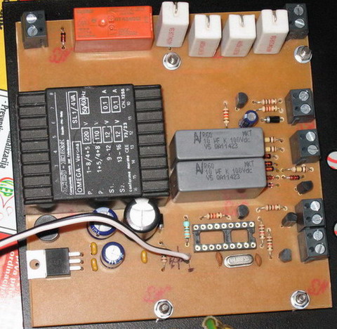

Finish. This is how the whole circuit looks:
Documentation. I am providing SCH and PCB files for Protel 99. You do not have to follow them in details, it is enough to take them as a starting point.
Also, in the attachment you will find full source code for mikroPascal for PIC. Again, the code is very simple, and it can be easily ported to C, Basic, Assembly or whatever. It has no more than 60 lines of code and it is very easy to understand.

Performance. I am very happy with this circuit. Firstly, it is very simple. It took me one afternoon to assemble it and to test it.
Secondly, program for PIC is very short. It solves a lots of headaches with various delays, logic etc. I wrote it in a moment of inspiration and I will keep it that way.
Finally, the protection is very fast. "AC off" detector is capable of detecting AC noise caused by vacuum cleaner. DC detection circuit is fast too, on ESP site it is said that it detects 5V DC in 20ms.
One improvement is recommended though, as I already said, try to use optocouplers to fully separate digital and analog grounds.
Recently I had a problem with one of the transitors in the amplifier. Actually, I do not know exactly what the problem was, but the outcome was that the insulation below the transistor did not do its job properly. Collector of the ouput transistor got short circuited to heatsink and therefore to chasis. Fortunately, the protection acted so fast that I did not hear any noise on the speakers, while the amp was sparking inside until the fuse went off. :bigeyes: I think a better spontaneous test could not be done.
Vacuum Cleaner detector
zristic, forgot to mention the AC detect and triggering on vacuum cleaner switchon....
This sounds like a mini brown-out affecting the AC detect cct.
A suggestion would be to increase the value of R? (the resistor between base and ground on Q1)....try 2K2 or 4K7.
Increasing the voltage at the base should implrove riding out the brown-out.
You could put a small capacitor 100nf - 330nf to ground on the base of Q1 as well. This would hold the base voltage during any downward spike.

Hi zristic,
Thank you for posting this project. Personally, there is a lot for me to study in it. I normally design using hard wired logic and time constants.
I don't know if you really need that much isolation between your output circuit and protection logic. Most amps don't isolate these circuits, although digital based circuitry may be different. I guess it might depend on how much noise comes from the digital stuff. My first thought on this would be "not much".
