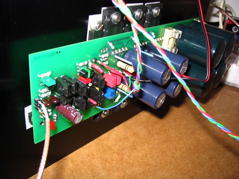

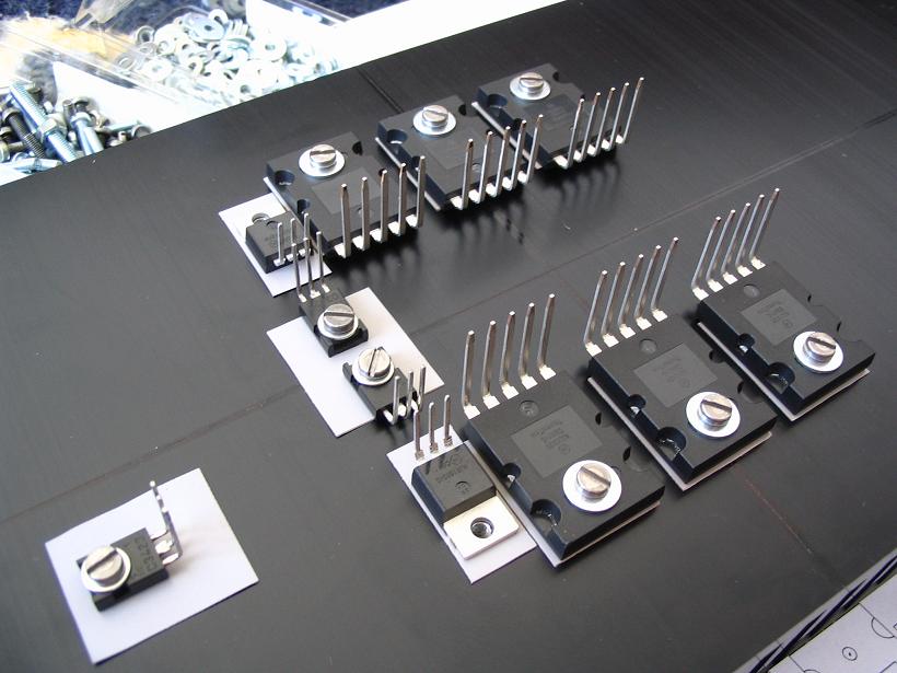

This is my latest amplifier design. For me, the quest of finding the best sounding amplifier is over.
Firs of all, I want to thanks to MikeB and JCarr, they was my source of inspiration and to Mr. Nelson Pass for a key advice regarding folded cascode topology.
This amplifier has borne as a freeware project and it is dedicated to this marvelous community of enthusiast people that adhere to share knowledge and experience.
I'll start with few pictures. Tomorrow I will continue with specs, amplifier schematics and front end regulated PSU.

roender said:
whazzat glowing utmost left ?
in any case -I'm curious to see that schm .......
It's a DAC.
I'm not sure what you mean, but if I guess correctly your question, the load for those led's is the supply line for reference CCS of input stage.

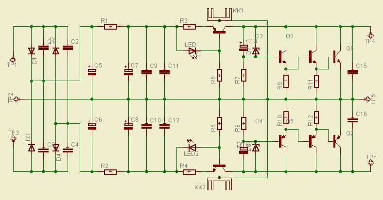

Zen Mod said:
SHUNTIE !!
It has very good behavior at HF and it is very quiet.
Much much better than a normal series regulator.

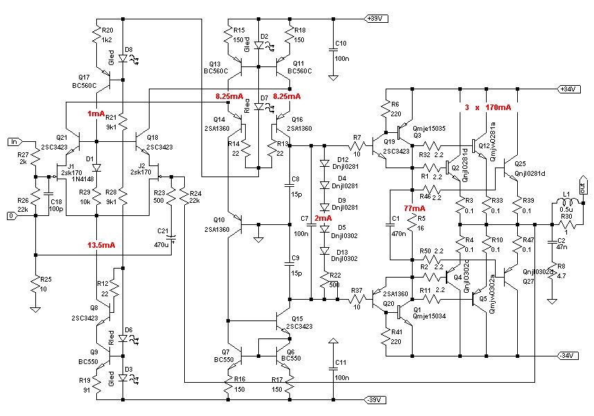

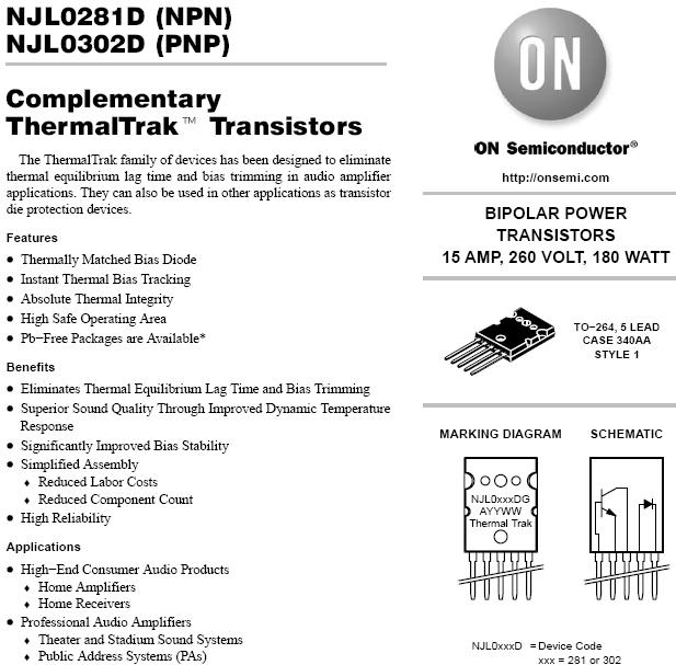

Why have you use a diode bias instead a more common Vbe multiplier, and could you give as some spec, like OL, CL, DF, etc...
aparatusonitus said:Why have you use a diode bias instead a more common Vbe multiplier, and could you give as some spec, like OL, CL, DF, etc...
those are diodes implemented in output bjts
lookie - 4 legs ....... almost as toob 😉
Did you see what output devices was used?
roender
D1 is there because of tempco?
also 2SC3423 .......... there are here because of noise and temp. behavior ?
tnx.
tnx.
