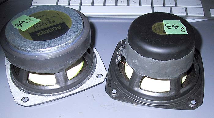

In an effort to find alternates we started playing with something called Silent Running SR500. This is a latex damping compound that dries to a hard sandable & paintable finish. It turns out it doesn't totally replace ductseal (at least without some effort) but works in conjunction very well). This compound is repurposed from the boat-building industry.
I'm just going to start by throwing up a few pictures (i have a lot more, plus techniques i've come up with etc)

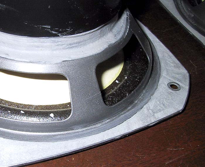

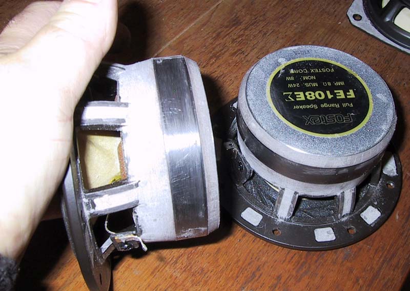

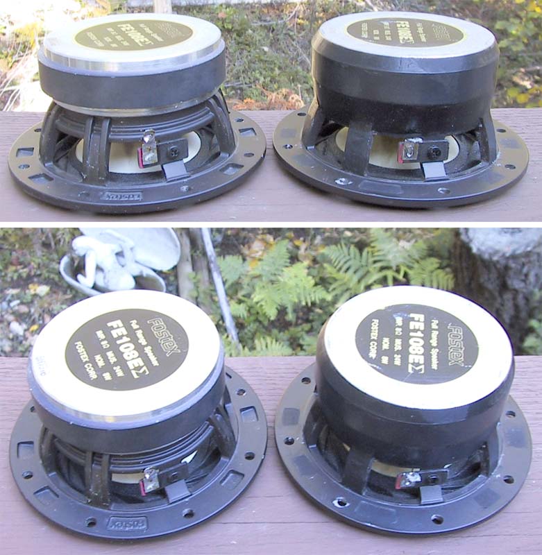

The duct seal won't go to waste. The SR500 is "painted on". To fill the magnet/basket space on the FE108eS took over 50 applications over a period of 4 or 5 months. Makes more sense to apply 3-10 coats and then fill the rest with ductseal.
Where it really comes into its own is to fill the open volume on the back of the stamped basket Fostex. This not only damps the basket, it quite dramatically increases its torsional ridgitity.
(the picture is a 167 just before painting over the SR500 and using ductseal to finish shaping the basket/magnet)
dave

We have 3 things going on here.
1/ stiffening. This holds the basket/motor together more tightly. This will affect all drivers
2/ damping. Killing off spurios ringing. This will affect all drivers
3/ shaping. This is wavelength dependent so will affect FRs more than woofers.
