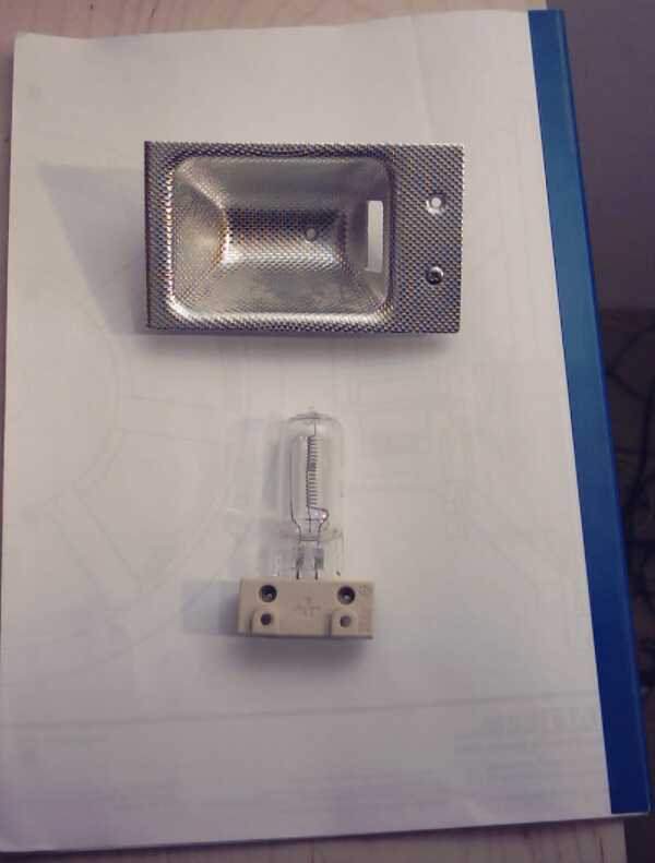

till said:Yes, but lighning ZEN is aestetically the absolutely best, and what would be a better use for these: ?
anything to change in feedbackloop?

Hey, i´m student. The TAD Speaker project keeps me low on moneys for some more month. A ZEN light with those lamps must look very pretty. But i would need 12 - 24 pieces for a twochannel amp. 17€ for 115W at 220V => 200 - 400 Euro for lightbulbs. I´ll try my halogen 1000W one each channel first. and i don´t need much more than some 100mW out of the amp with the TAD´s!
