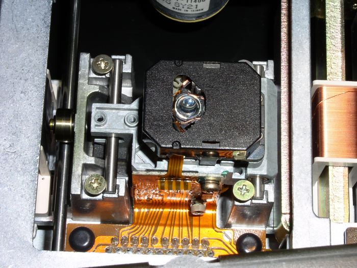

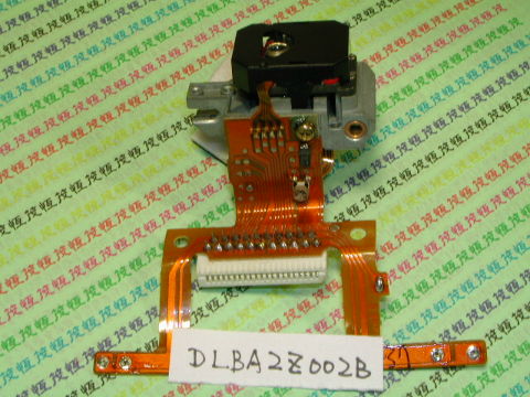

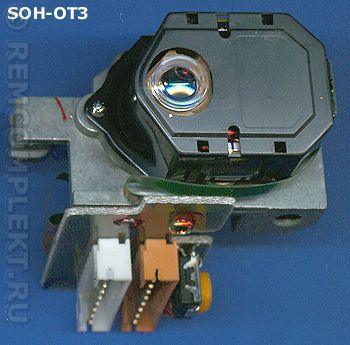

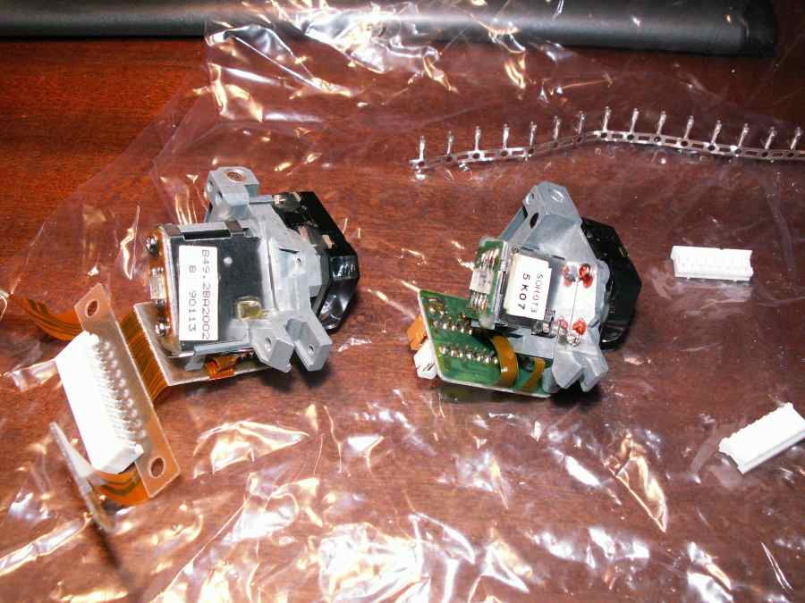

It can be replaced by samsung SOH-OT3 (SOHOT3)
Large photos of a head Samsung SOH-OT3 can be looked here :
http://s-10mitino.narod.ru/lazergolovy/soh-ot3.htm

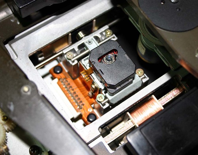

The same can be tried with a head Toshiba TOPH7833
In newer Kenwood DP-8020 there is a head Sony KSS-152A
It is possible to replace a head just as in this device :

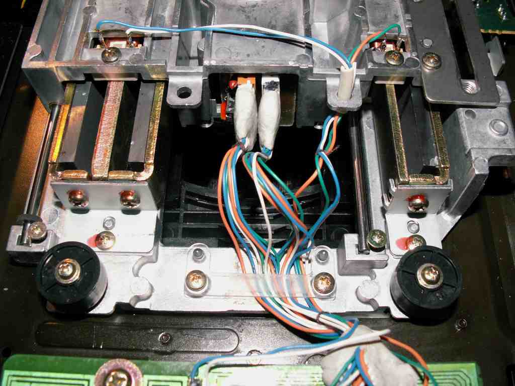

We would like to try to put in the Sony KSS which is a replacement type of the samsung laser unit. Do you have any further information about the wires and where they should be soldered? Do you have manuals or schematics of the laser units?

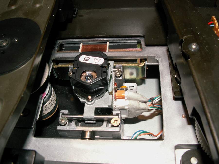

1.) The Toshiba TOPH7833 is said to be compatibel to the KSS152A. Would that mean that even a KSS152A is worth a try?
2.) From the photos it's not completely clear (to me ...) what you did with the trimming potentiometer for the laser power. Did you leave the original Kenwood trim pot on the foil and remove the trimming potentiometer on the Samsung SOH-OT3?

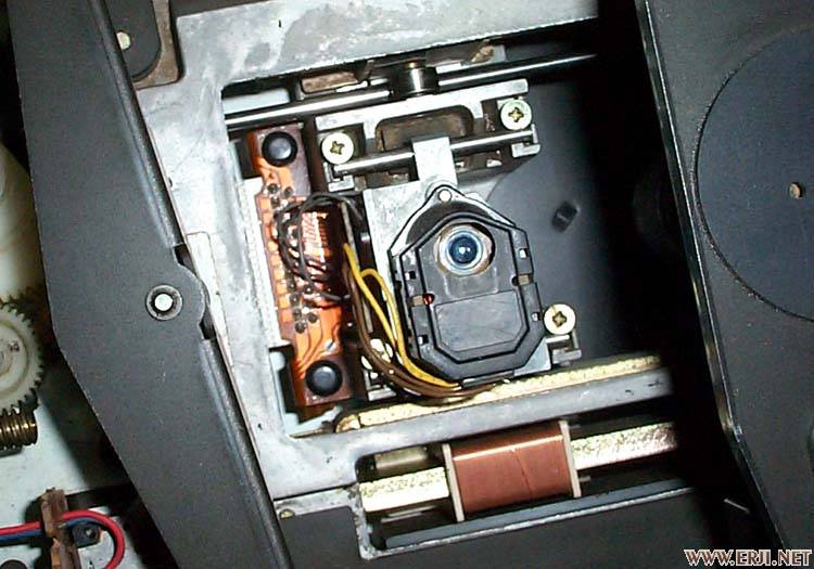

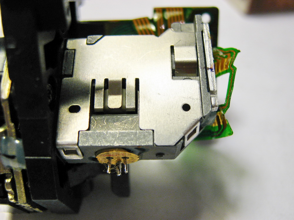

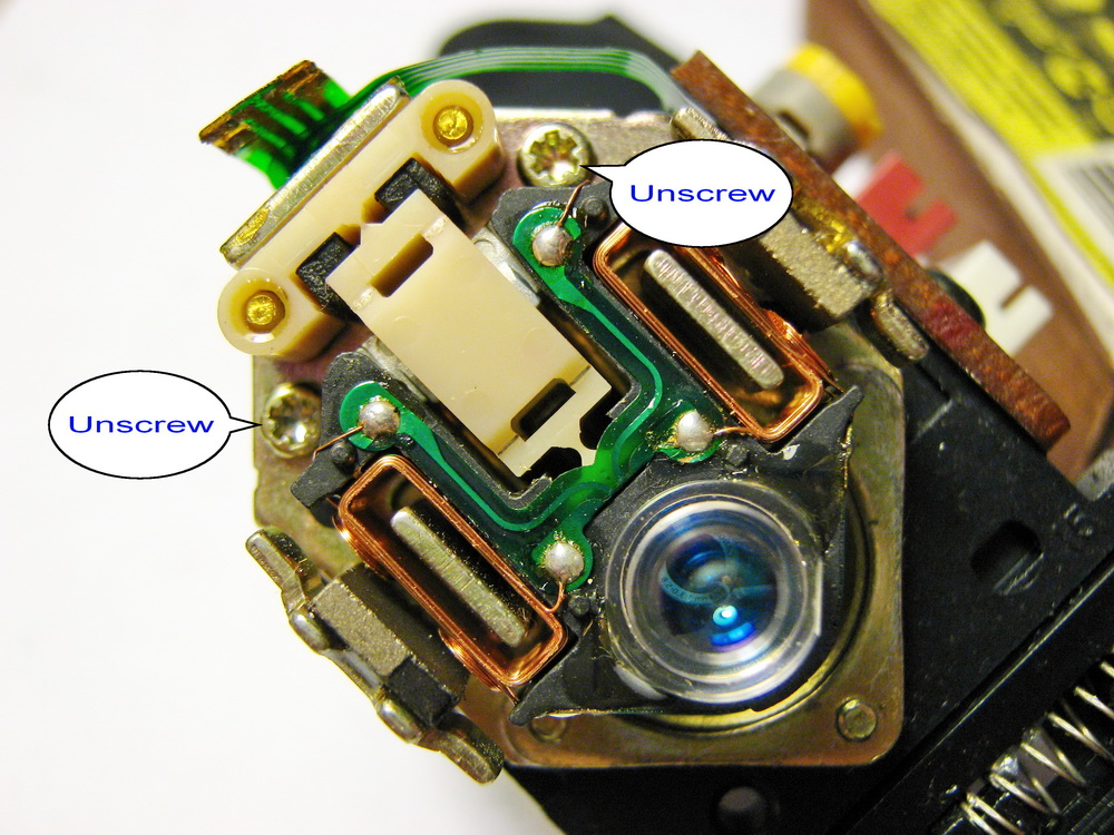

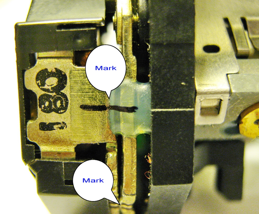

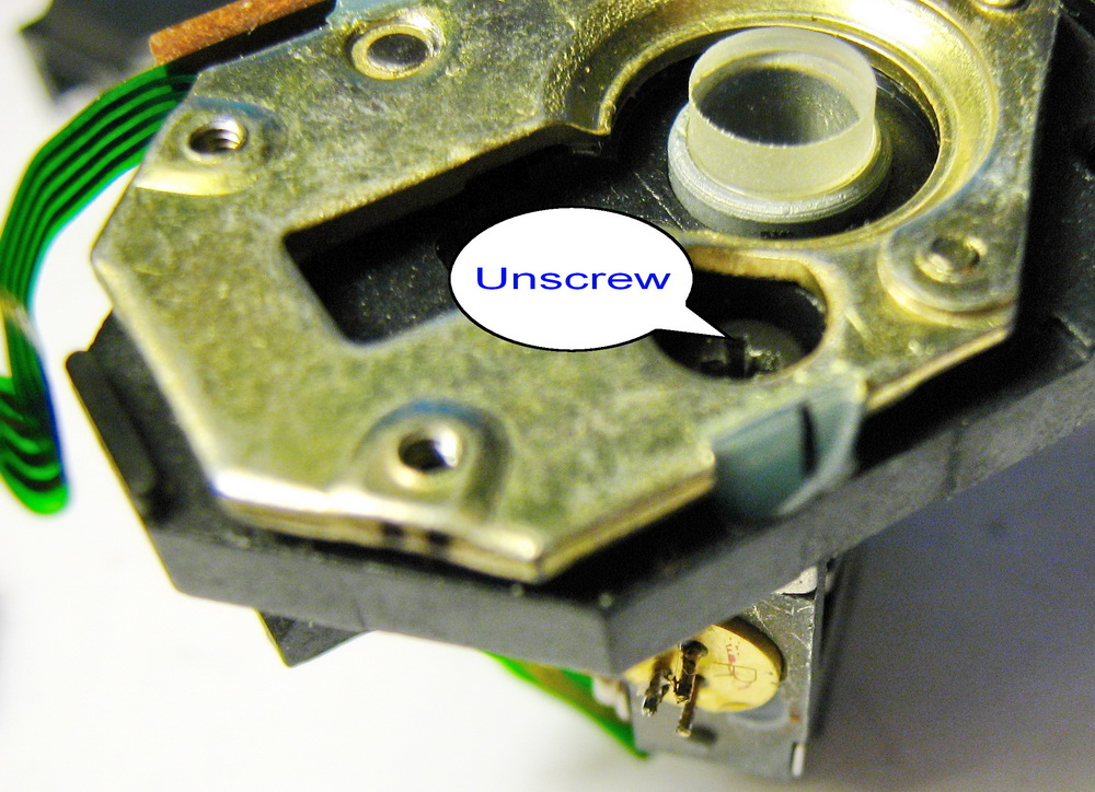

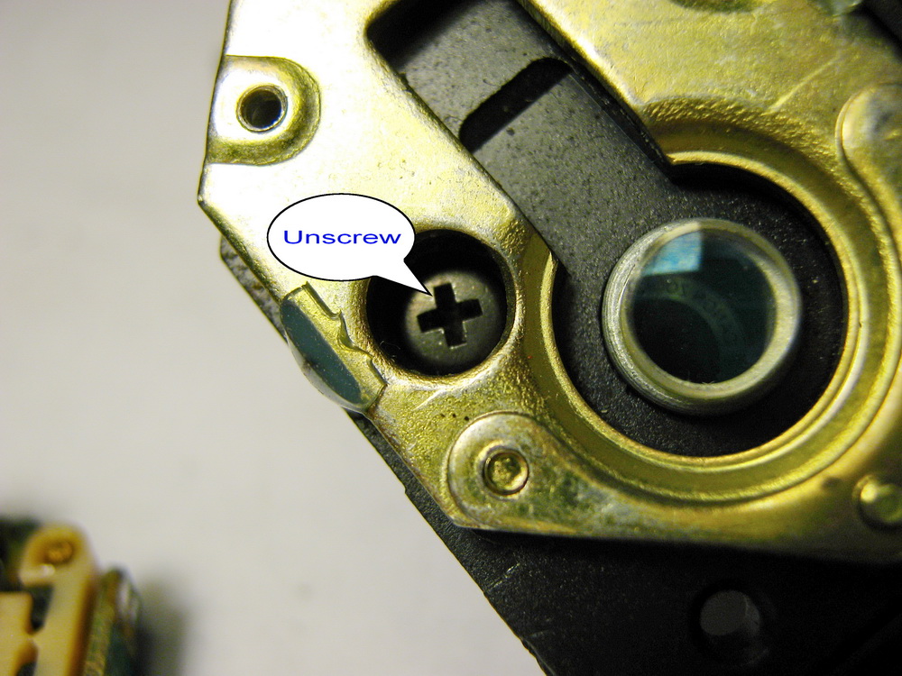

KENWOOD DP-8020:
To restore the head of KSS-152, I used as a donor KSS-150B, that is, its metal block on which the diode and matrix. Suspension from the lens and the focus and tracking coils leave home with KSS-152, otherwise it will not work. This optician (old style) it is difficult to find, but still possible. Applies, for example, inexpensive models SONY, and many other low-cost devices.
There is a risk that does not work, but generally, the procedure ends successfully, the main thing that at the time of transplantation loop, not fallen off the matrix. And you must be sure that the donor worker. Several times did this reversal, and it works fine! Trimmer also put a donor!
In KENWOOD DP-8020 did not have to make adjustments, it all fell like a native!

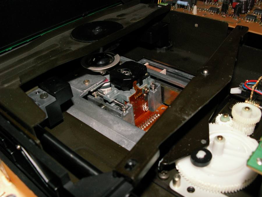

Some time ago I was made succesfully replace original DLBA... for SOHOT3 (KSS152) in DP-X9010. Maybe is not pretty done but works dam good.
