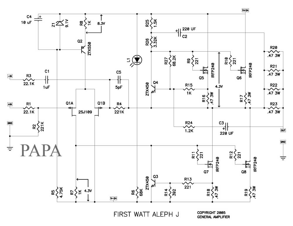

Aside from the jfet diff input with bjt ccs, looking at the output ccs...is R27 really between C and B of the voltage reference npn transistor (Q4)? Thanks for posting the circuit.
hehehe
R27.........
that really doesn't matter
C2 is pretty good decouple even across R26

First to say: Thanks a lot, Nelson! :up: :up: :up:
After a quick look 2 questions raised:
Which type of 2SJ109 is the right one. With a current of 4 - 4.5 mA running through each of the FETs, the GR type seems to be inappropriate. BL and V should work in principle, but I lack the experience to decide which one would be the better choice.
Maybe not so important, but the current through LED1 seems to be very low.
