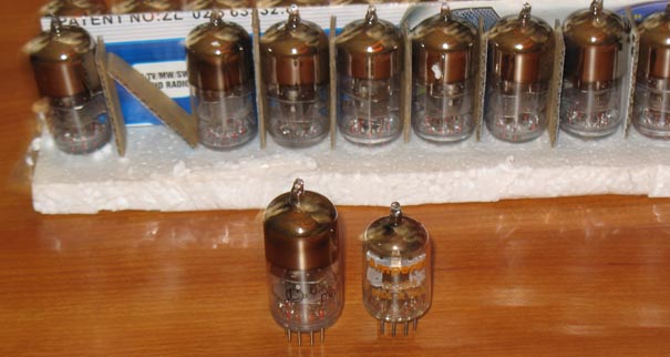

Anyone know anything about this tube? According to the guy I just bought 20 from, they are 6688/E180F equivalent, but I can't find a datasheet to verify this. Anyone tried them?

Duncan just has pinouts, I'm sure you've found:
http://tdsl.duncanamps.com/tubesearch2.php?TSD=6j9p
My suggestion, breadboard an E180F pre and get it working just right, then drop in the 6J9P and see what happens.

Geek said:You find the oddest stuff 😀
I'm always on the lookout for cheap stuff, and the 6688 is just about my favorite tube, but at nearly $5 per tube it is just too rich for my blood 🙂 -- so, for $1 each (ebay), I just couldn't say no.
Yeah, I figured I'd just drop them into a working circuit, but I also thought I should ask about them in case there is some unexpected weirdness.
