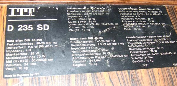

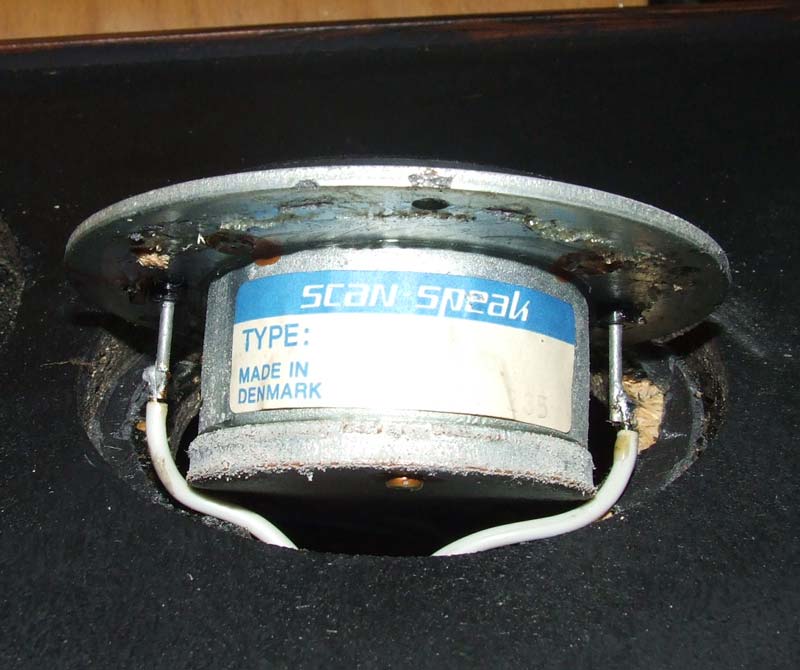

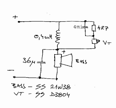

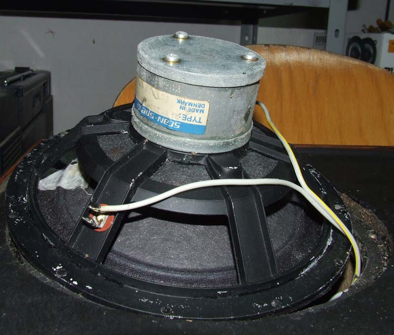

I need any info about old SS drivers-21W38 and D3804;
both have Alnico magnets,and originally they are from old ITT boxes (probably when SS was just OEM supplyer).
btw ITT box have D 235 SD mark.
looking at xover (attached),and box (in fact-two chaimbers in one box,with sorta variovent bariere in between),seems that whole speaker is SS made.
any info?

My surprise was even bigger when I realize that xover is series-type and
that box is of aperiodic type!

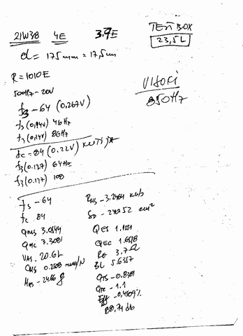

I also attached few pics in Diyaudio posts,one is xover schematic and
other is Thiel-Smal parameters ,which I measure;
You can find also this two pics attached.

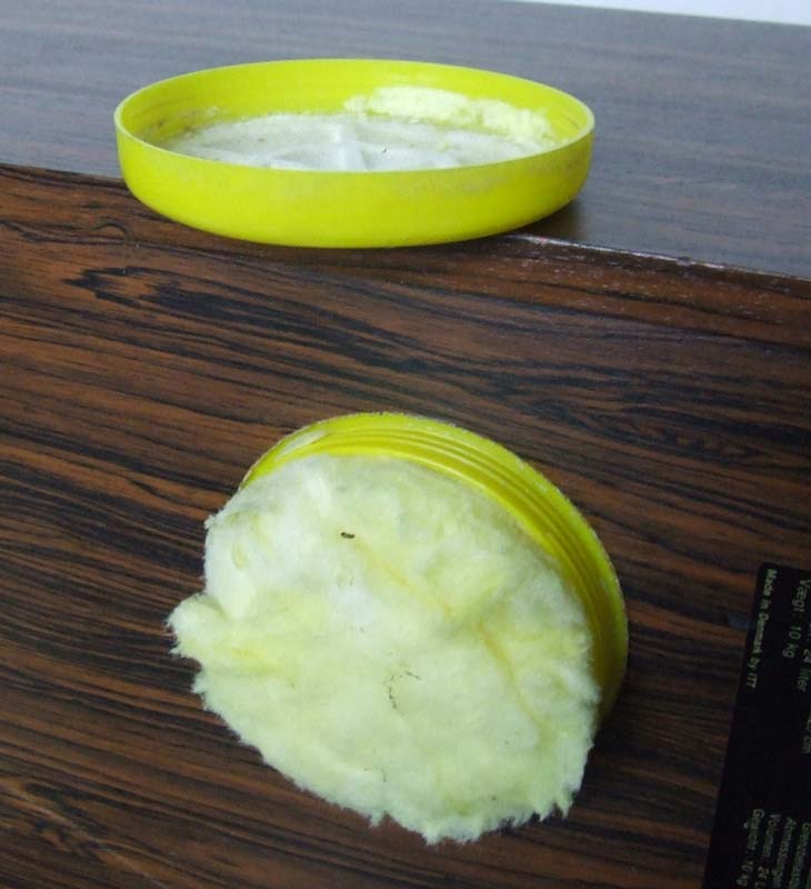

I change old electrolytics,rechecked twice sealing of drivers in box,and
even tried sort of variovent on back of boxes;
