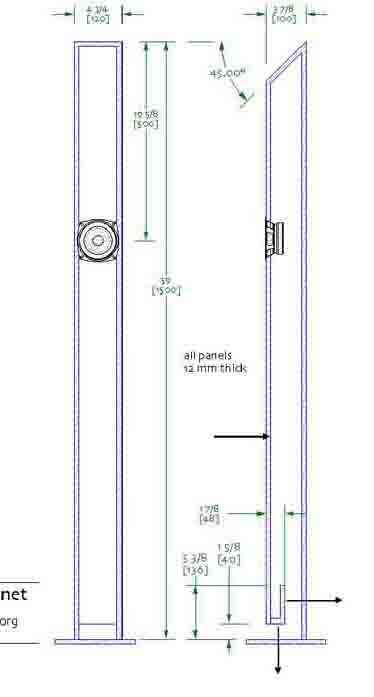

I was wondering if someone here who has built the Zigmahornets could tell me what the measurements should be for the items that I have indicated with an arrow.
The plan that I got off this site is not very clear to me on this particular area.
Please let me know the measurements in inches.
I have attached a jpg image.
Any help would be appreciated!

thickness is 1/2", I built one a while ago, but can't read the numbers on the picture u uploaded.
If u can lable the arrows A, B, C, will also help and I should be able to give u the size measurement.
gychang
gychang
Well, the vertical line you indicate is just the total height, minus the 40mm for the vent and 100mm for the slope (it's a 45 degree angle, i.e. a square, so height X & y dimensions have to be identical). The depth of the vent is clearly marked (40mm), so nothing to worry about there. The horizontal arrow you've added doesn't appear to be going anywhere at present. You can make the base any size you feel like, even stick them on a sheet of 8' x 4'. It's not going to do anything to the design.

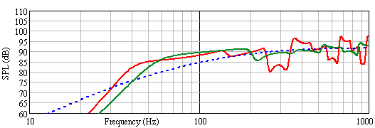

mluckow said:Also, are the other parameters of the FE127e driver appropriate for the Zigmahornet? (I assume they are, otherwise you wouldn't have suggested it, but thought I'd better ask to be sure.) I noticed that the Vas is pretty different from the FE103.
I was so bummed when I found out that Dave Merrill's drivers are no longer available.
The zigmahornet was designed before TL modeling software came along so it really isn't optimal for anything. Its one real asset is its elegant aspect.
dave
mluckow said:FE126e and FE127e,
Ropie (aka Robert Powell) put FE126 in Zigmahornet. You can read about it in October Affordable Audio page 34.
http://www,affordableaudio.org
FE127 should be better suited than FE126
dave

chrisb said:but deep bass and higher SPLs wouldn't be on that list.
Given how low they go, you can actually get away with a LOT smaller box (and lose some ripple at the same time). IIRC from the sims that Scott did, it has similar bass perfomance to a set of Solo 103s.
dave
