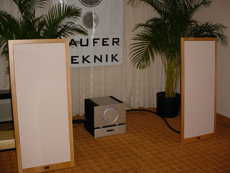

Re: Curved baffles?
The curved baffle flattens the response. In my Big Audio Dynamite thread, I modeled a dipole of approximately the same size as the DP-1, but with a square baffle. The problem with narrow baffles is that response "blips" occur at higher and higher frequencies as they get smaller. Putting in the effor to use a non-rectangular baffle will help.
mac-attack said:Hi,
Noticed that the Lyngdorf DP-1 has a slightly curved baffle, so does the Jamo R909 open baffle speaker even though that speaker has a much wider baffle. What really the incentive for the curved baffle, is it only a visual design feature?
M.A.
R909
