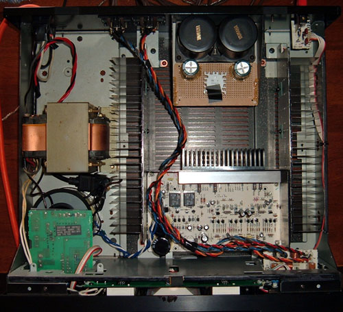

I am taking a Yamaha M-45 and replacing the amp section with
Aussie Amp NX series modules. I am going to continue to use
the front 'power' meters; attached are the pictures of the 'schematic'
of the meter circuit for the Yamaha M-45.

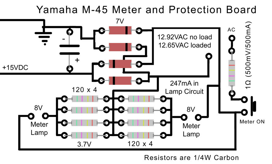

Power Supply and meter lights. The main transformer has a second
set of secondaries. . .that is what runs the meter and panel lights.

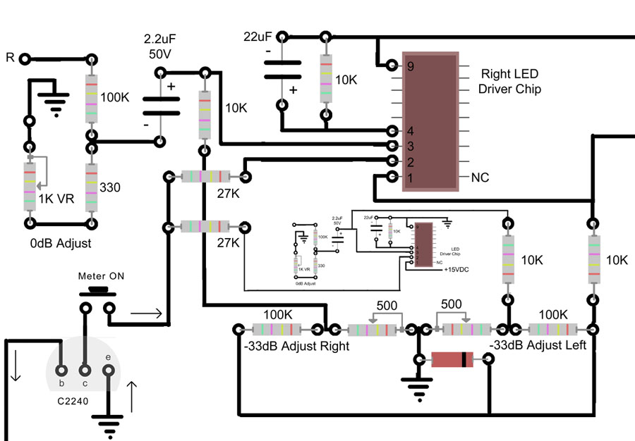

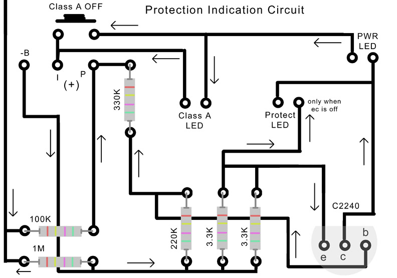

Yamaha M-45 main meter circuit. Input is from amplifier output section.
The transistor C2240 is switched via the protection circuit and opens
the connection for the meter circuit to become active.
I want to take C2240 out of the circuit and replace with a jumper between
ce since the protection circuit is no longer in the amplifer. With
no power to the protection board, there is no +V on the base of
C2240 to allow the meter board to turn on.
I was thinking of testing with a 10 ohm resistor first. . measure voltage
drop and calculate current. . .see if it will turn on meters. This
branch of the circuit goes to a 27Kohm resistor then the LED driver
chip.

Meters now work with other amplfier. . . Removed transistor and
replaced with 15kohm resistor.

Yamaha watt meters and dB don't match. . .250W is not +9dB of
125W! It is +3dB. . . marketing. . . "Look, our amp can output +9dB!"
Changing the meters by a factor of 10 seems reasonable. . . the
old [0dB] 125W would become [0dB] 12.5W. The input resistor
is 100K for high level input adjust and 10K for the low input adjust.
By scaling them down. . .the meter would be more sensitive to
the voltage. . .thus read lower values. It would only take 10V to
run the meter up to 125W LED instead of 31.62V.

Radio Shack Accurian Receiver amp section installed in Yamaha M-45
shell; power meters work. Pictures to come.
