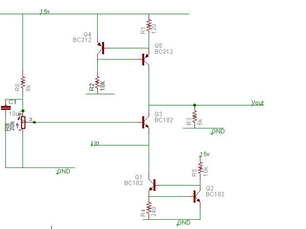

Hi All,
I have finally managed to build a discrete IV stage for my TDA1541A based DAC.
I've only just got it working, with my 'experimenting' PSU (only regulated with 7815/7915) and have only listened to it briefly through headphones.
However, on first impressions it sounds alright actually. I think there is a lot of detail so far. I am looking forward to feeding it from my DAC PSU, which is regulated with lm3x7, and then TL431. Then I'll be able to compare it to my humble LM6172.
The circuit is a duplicate of the one posted (obviously for stereo), but the voltage bias (generated by the 20k trimmer) is shared by both channels. I assume this is good practice, as it sets the gain for both stages. Or should I have two biases? One per channel?
Adjusting the bias is subtle, and at extremes causes distortion, so I suspect I will need to adjust it using a test CD and oscilloscope to ensure distortion is reduced/eliminated as best as possible.
I am also hoping to get this running on a split supply, rather than 0-15v, as the DC offset is quite large.
Also, I suspect I will follow it with a current sourced CFP based emitter follower, and I'll add a voltage offset to reduce the DC offset to zero.

6K is probably a bit high for a TDA1541A on the I/V resistor... usually you see around 1.5K. Also, you might want to use a 1st order filter, say around 1.8nf or so in parallel with the I/V resistor (off the top of my head, and with the 1.5K).

Is the 6k resistor the IV resistor? I thought it was used to provide a voltage bias for the common base amplifier - although I'd be lying if I said that I completely understood this circuit.
I use this bias for both IV converters (left and right) and I still have a stereo image, so I suspect this isn't an IV resistor.
I do suspect 6k is a bit high though...

I think he means R3, not R6...

To start with you may try adding another 10-22 uF capacitor between the ground and the base of Q3. At the moment the base is looking into the pot and can see up to 5K there. It will transfer directly into 25-50 additional Ohms of the input impedance.

The schematic I knocked up is a record of the circuit I built, not exactly a design. As you can guess, I have an abundance of 6k resistors, BC182s and BC212s! They seemed reasonable values at the time.
That makes sense, and is something I else can change. My op amp I/V uses 1.8k, so again it does seem a bit high.

The 20 k potmeter is to set zero volt at the input (within +/- 25 mV) so that the DAC will be happy. It is not gain setting, the gain is determined by the ratio of 6 kohm to 120 ohm. 1 mA on the input results in 0.12 V on the 120 ohm resistor, which will be amplified by 50 x, so you get 6 V peak for 1 mA. The TDA1541A gives 2 mA full scale, so you will get 12 V peak or about 8.5 V RMS. If this is too large, reduce the 6 kohm to, say 1.5 kohm.
In the opamp I/V the 1.8 kohm determines the transconductance, not the gain. The input impedance is actually much lower, in the order of milliohms.
I like your design. Just make sure it does not drift with temperature (I mean the input 0.00 mV DC voltage loaded with the DAC chip).

design! LOL! I basically found a very basic common base amplifier and replaced the collector and emitter resistors with current sources as a starting block. There really wasn't any design involved (as you can tell from the use of a pot instead of a variable resistor).
In a lot of respects, the opamp solution does seem more ideal - especially wrt to pleasing the DAC's criteria. However, I am impressed by how this sounds - probably because its class A and there's no feedback.
From everyone's words here, I do suspect my large load (I/V) resistor is a tad high. It might explain the subtle clipping I've been seeing with large signals if not correctly calibrated.

I reduced the load resistor to about 1.6k, added 100uF between the base and ground, and turned the pot into a variable resistance, and it sounds lovely. Its much easier to adjust now to reduce distortion. I think its an amazing improvement over the opamp IV. I don't think I could turn back.

You don't have any "physical" I/V resistor here. It is formed by the input impedance of the common base transistor. It is given as the common base h11 parameter which can be derived from the catalogue common emmitter h parameters. I don't know the formula by heart, but I can look after it if you are interested. The goal is to keep it below 5... 10 ohms. If it is higher, you get clipping -> distortion at signal peaks.
Another reason of the clipping could be that you have some DC voltage at the input. You can safely measure it in-situ with a CD millivoltmeter. The goal here again is to keep it below a few millivolts. The servo that janneman proposed is a good idea, but if the circuit does not drift, it might not be necessary.

I should have written 'large load (I/V?)' because I agree its not the IV resistor as you'd expect in a passive sense, but others had called it that.
I know it works differently to passive versions in the sense that it is basically providing a tiny input resistance for the current output of the DAC, and then applying voltage gain - as opposed to providing a smallish resistance to convert a current into a voltage - which is less desirable for a DAC.
