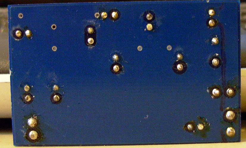

Here's a pic showing the trace and circuit layout as best as I can manage:

And another showing some component values:
I will measure any components I can.
The aim is to try and separate the digital and analogue supplies and feed them from external low-noise regs.
Lee.

First of all you need to look at what chips etcv are on the pcb
LM336-2.5 is a 2.5V ref diode (actually a ic but shown on a cct as a diode, very low noise)
TL084 is a quad opamp and very good for noise rejection on voltage rails
I can also see the freq ref cap is missing (smt)

So basically the clock two chips with its caps and res form a low noise regulator which feed the whole pcb.
Maybe the quad opamp chip actually feeds two or more rails out of it with the one 2.5v ref.
Its actually pretty good but the only suprise for me is no drive transistor, I know the clock 3 has a drive transistor on the pcb

I have checked the spec sheet for the TL084 and they seem to be driving the voltage output from outputs 3 and 4 (pin 8 and 14) with pins 9 and 13 (inputs linked) possibly the 2.5V ref here.
I can't tell from these pics but all 4 outputs maybe connected together

Bloomin' eck. you don't hang about! I was still looking for datasheets etc to look at.
I have two of these btw.
Would it be worth adding that smt cap? Also, where there's a wire link on this one behind the xtal, there's a cap on the other clock.

Audiocom did change the caps etc on some. If you are feeding it with a low noise reg then the cap is not so important as when you are feeding from a crap supply.
I would fit that cap, its part of the tuning circuit

The reg is tx, Schottky's, 10,000uF 63v BHC Aerovox Alt, lm317 with 4x10v zeners for lower noise, 3300uF 16v bc Comp, and 100uF BG FK between Vin and Gnd directly on clock pins. All that and it's not that good!
Any idea on the value of that cap, looking at the other clock that's in the player, it doesn't have it either. Is it the 12pf one?

The cap is 18pF
The 3300 may be slugging it down and i dont think this is necessary. The FK would be ideal in that cap location. I always keep psu component count to a minimum.

Cheers for the help mate. I've removed the clock from my player and looking at the back it seems that I may have damaged one of the traces!
I have now put the other clock in the player and it sounds loads better.
I will whip out that 3300uF cap from the psu.
When I next order from Farnell I think I'll get a couple of the ADtl084 chips. The datasheet says it's an improved version of tl084 with better ps rejection and a faster slew rate etc. Maybe worth a go.
Are you sure that cap is 18pf, it's for the dac (16.934 mhz)not servo.

Whoops sorry i was giving the cap value for 8.46mhz hehe
yes 12pF for dac clock 16.934

I have just realised something after looking again at the circuit. It's not a cap linked out it's a coil.A linked out supply cap would not be good.
The later SC2 came without it. Best left out if you ask me.
