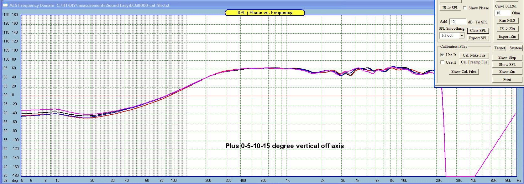

Attached are some photo’s of the almost complete project, some as-built frequency response measurements on and off the horizontal and vertical axis as well as individual TL terminus, driver and reverse null measurements. The finish is Santos Rosewood veneer in high gloss with high gloss black on the horizontal elements. I hope this is not too big a post and images!
The last image was cut off, so here it is, the plus vertical off axis measurement.
My room is about 15'w x 20' deep, with steeply vaulted ceilings from the end of the room the speakers are in over about 12' of that 20' depth. The speakers are about 3' out from the front wall and 3-4' from the side walls. It is a somewhat open floor plan and this room opens up into other rooms as well. This is our major living area and and they are used for HT and music.

Here are a few more images. The crossover, which also includes a high pass to the RS150-4's, the measured impedance and impedance phase and the measured frquency response with the phase shown. The phase tracks very well from around 400hz through 2.7khz (see the red, black and blue phase lines). The purple phase line represents the phase with the reverse null at the xover point.
It's a pretty standard LR crossover, 4th order acoustic, not electrical, with a zobel on the RS150-4's, but it attenuates the woofer breakups by 40-45db .
The reason for two drivers is primarily due to losses from your listening axis being 90º off the drivers axis and alos due, I believe, to the fact that they are really playing in 4pi space throughout their range rather than 2pi for part of the range. The woofer firing at each other in order to better integrate them with the tweeter. The output is much like a single driver in many ways, IMO. The distance between them is quite important and was subject to a lot of testing in this and my prior omni project. Get them to close together and you start getting peaks and valleys created by interactions between the baffles and drivers. Get them too far apart and they won't sound as integrated. They are 9.5" apart, which is actually about 1" closer than would be practical with these drivers on a traditional flat baffle, so they should integrate better for that reason alone. I have not found any lobing to occurr vertically or horizontally off axis in my measurements.
