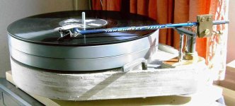

Well, finally here it is, my first diy scrapyard turntable.
As I was very happy having a few thorens parts doing nothing in my scrapyard I started building an new turntable using these. So the turntable can also be regarded as an extreme make over or a drastic tweak .
Attached an overview image.
More in the next post.

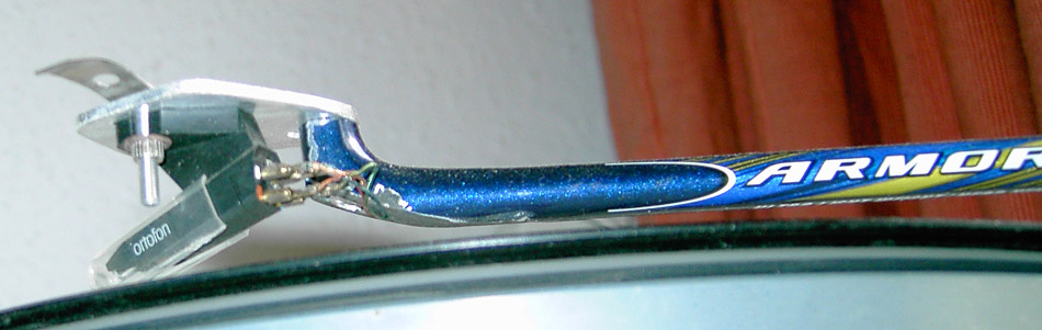

Arm detail
HEre a photograph of the arm part of the turntable (yes, I know, I'm a lousy photographer).
The arm I regard as having build myself (otherwise it should be considered as a major tweak of a badminton racket). It's a full carbon arm with an aluminium head shell and a brass counterweight. Of course I used an unipivot. The VTA is adjustable in a wide margin (about 5 cm).
Marco
Marco
Details and a question
A little on the details of this turntable.
The plinth is solid concrete in which a part of the sub chassis of a Thorens TD160 is embedded. This basically gave me a standard Thorens bearing in a concrete plinth. The sub chassis gave me a means of having it exactly vertical (as I assumed that the bearing is mounted axactly right in the sub chassis metal).
In this bearing a standard Thorens sub platter. I actually used a fibre one. I didn't need the mass of a metal one, and I believe the damping of the fibre one is better. On this I stacked two Thorens outer platters. I made the spindle longer.
I plan to fill the top platter with either concrete or Acryllic resin. I get worried a bit about the weight. How much platter weight can a Thorens bearing support before wear gets excessive? And when it does would a small Teflon plate on the bottom of the bearing help?
The motor is again a standard Thorens TD160 (synchronous AC) motor, but driven by my own power supply (wien bridge oscillator, power op-amp, step up transformer).
greatings, MArco

Arm details
The arm I've made from a badminton racket. Actually these are well suited for the job (at least the one I used). The shaft is hollow and made from carbon. But the part where the counterweight is mounted is solid (that's the part here the racket handle was mounted on).
I left a small part of the blade on the shaft, so I could fix a flat piece of aluminium as a head shell (see image). The nice thing is that there is a little bit of metal at the end of the shaft so I could use a little bolt to fix the aluminium to the arm.
I created enough degrees of freedom in the cartridge/ arm/ head shell mounting that I can have the cartridge properly aligned AND the needle exactly under the middle line of the arm (actually the line around which the mass evenly distributed in that plane). I think that's vital to keep an unipivot arm from wobbling in around it's length axis. In this way I could avoid dampening this movement.
The counterweight is made of brass strip and is clamped on the arm. Heat shrink tubing is in between. The counterweight has a few screws for azimuth adjustment and tracking force adjustment. The thread for the anti skating is also attached here.
The point of the unipivot is a dart, which I've mounted in a piece of water pipe by means of molten lead and tin. I've inserted a little tube as well trough which the arm cable runs (made from a dead mouse).
The water pipe is mounted with a standard clamping water pipe support. (excuses for my horrible English here). I hope you understand.
The arm lift is again made from a Thorens part. A bicycle brake pad supports the arm. A bicycle seat post handle is the lever for operating the lift.
Well, that's about it.
As the whole concoction operates flawlessly it's time to mount a decent cartridge. First I have to make a phonoclone for that.
greetz, MArco

Hi miniwatt,
thank you for the nice words. At least someone seams to like it. I think most people are put of by the distinct low-fi looks. Although it is designed to LOOK very low-fi, at the same time it was designed to sound very hi-fi.
Well, I'm not quite convinced that a builder of a piece of audio equipment should comment on the sound (especially of the person designed it as well).
So I'll refrain from any hilarious comments especially while the budget test-cartridge (Ortofon OM-20) is still playing.
Nevertheless, I can conclude that it sounds better than both a standard Thorens TD 160 MK II and a modified one.
The sound is much more relaxed and firm. For example the record of Paul Simon's "Graceland" always sounded much more "bouncy" and not at all relaxed than the CD. With the new turntable it sounds much better.
Also wow and flutter is less, easily audible on Erik Saties solo piano work.
By the way, I think a badminton racket is an excellent source for arm material. The weight distribution is quite good as I obtained an arm-cartridge resonance frequency of about 12 Hz without any tuning or tweaking.
Greetz, MArco

It appears you used everything but the kitchen sink. You did a marvelous job and should be commended on your ingenuity.
Thank you for the kind words. I DID use the kitchen sink though (at least, sort of). The turntable actually started out as a test case for making my kitchen sink out of concrete.
As I do believe that tests should always be for real somehow, I decided to make a turntable as a test. I learned a lot of that, especially that I won't use this particular type of concrete for a kitchen sink.
greetz, MArco
