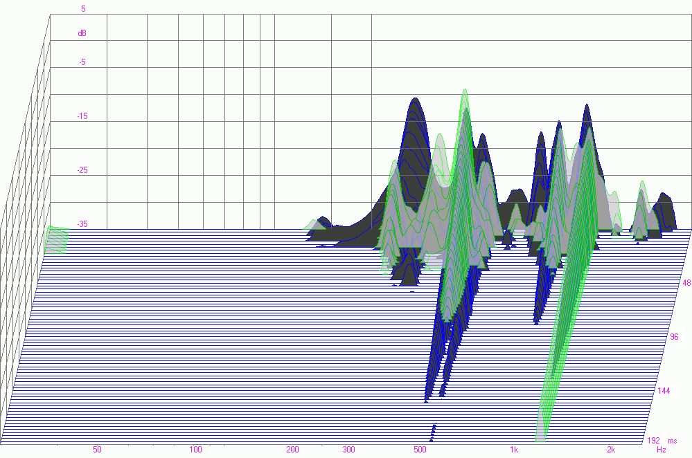

Most commercial cabinets use it because it is cheap (to buy, to use, to finish), Manufacturers have propagated the MDF myth so far & wide, most of them believe it themselves.
Properly done, a plywood cabinet will be less "resonate" than MDF, and doesn't suffer the energy storage of MDF.
dave

MDF cabinets often have a dull "thud" when slapped with the hand. The frequency is low, the amplitude is usually quite high. Baltic Birch is usually higher in pitch, but the amplitude is low.
recall that the speed of sound in solids is greater than that in air, and faster in dense materials than in less dense materials. It becomes a matter of energy storage, and the amplitudes of the energy release from these materials. Try it for yourself.
the higher pitch from Baltic Birch ply is a result of greater density. faster wave propagation and faster energy release than MDF.
