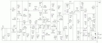

may I........ ?

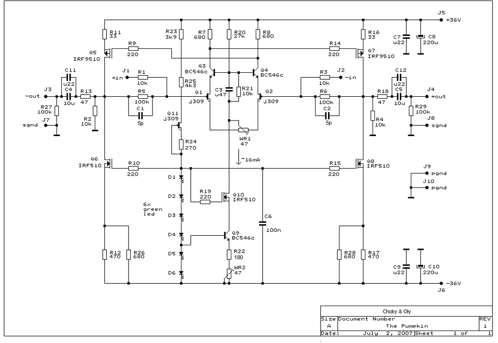

let's see ..... there is Papa-like product , well buried in "official" thread about :Pumpkin:
position: Preamp
cause : why not

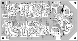

I'll send main pcbs , tested , on Monday to Mr. Simovic , AKA Ar2 , hoping that they will arrive to SF in time for BAF.
unfortunately , reg pcbs can't be finished for this occasion , and that will be main reason why 😛umpkin : will certainly sound awful , and soon I'll be just one of many ex members of this board...... I'll not survive that public humiliation .......
anyway...... there is main schmtc

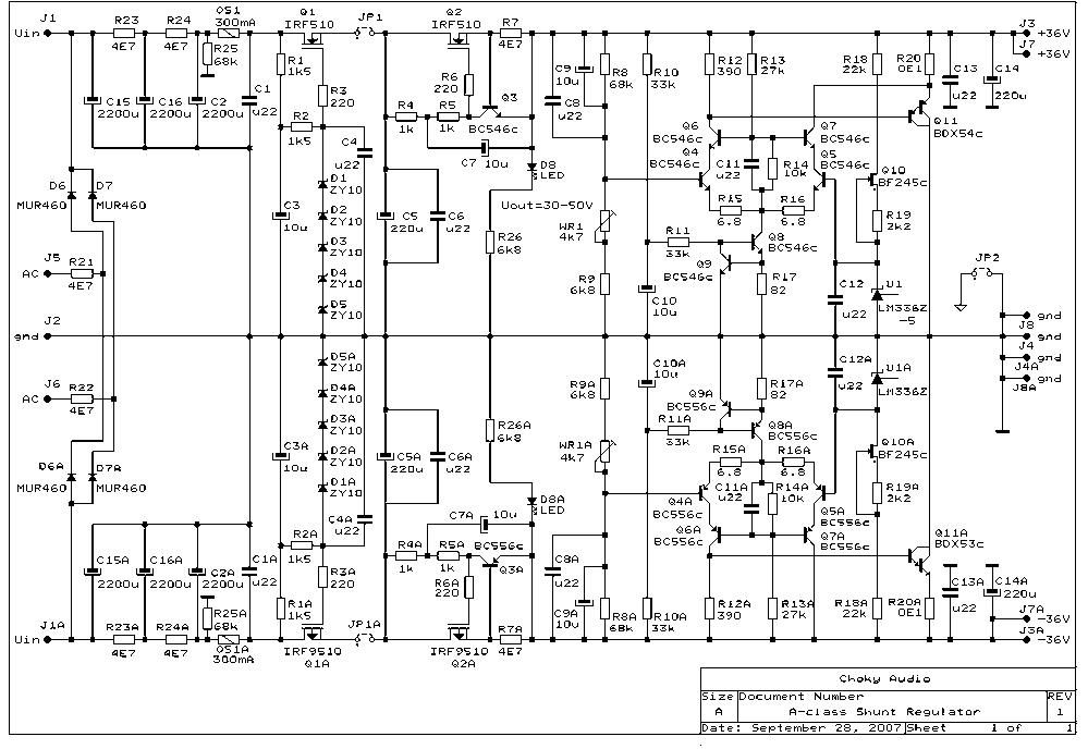

I forgot to say - AR2 will arrange generic +/- reg, just because ashes of :Pumpkin: will belong to him,after burning........
and yes- decent pot,too .

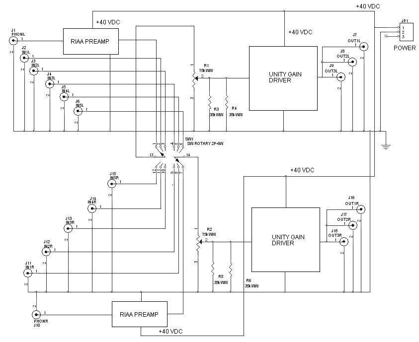

OK, I'm bringing an open loop (no global feedback) preamp with RIAA stage and unity gain line driver. The schematic for the overall preamp is shown below. This is housed in a humble Ten-Tec box and serves as a test bed for various RIAA preamp and output buffer experiments. The box is powered with a +40VDC external supply which also contains a 25A relay for switching all my other audio components. The single 40V supply intentionally limits what I try to fairly simple single-ended circuits, which is the whole brief of this line of experimentation, about 2 years old now.
Some of the past and present occupants of this box are described in the threads "Open Loop Follies" and "JFET SRPP". The box currently uses a pair of Bourns 100k conductive plastic pots with 19k metal film law-fake resistors for volume/balance controls.
The RIAA amp currently in use is the JFET SRPP preamp described in the aforementioned thread, and the output buffer is a heavily biased NMOSFET/PNP Darlington "super Gm" follower with current sink loading.
Before I show up at Burning Amp, I'm swapping the SRPP preamp for an open loop single-ended discrete JFET/MOSFET amp, pieces of which are described in the threads mentioned. I just finished tweaking the bias on all stages Friday afternoon, and will be testing gain on Monday using the HP gain-phase analyzer at work. As soon as I'm satisfied, I'll post a schematic and picture. The JFETs/Mosfets used are very intentionally ones that can be easily found at Mouser, to prove a point....
The conductive plastic controls will be swapped for a pair of of NOS Clarostat 75k, 2W wirewound pots with a pair of Micro-Ohm 35k precision bobbin-wound resistors in parallel each for law-fake. The combination scans very flat on the impedance analyzer at work. I'm looking forward to hearing an all-metal volume control.
I may keep the super-Gm buffer, or swap it out for a cascaded MOSFET follower circuit. It would be interesting to bring an assortment of pieces along, as the RIAA and buffer modules I have built so far are interchangable and only require about 10-15 min of soldering to swap.

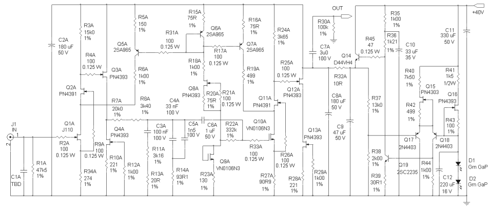

Ok, schematic for RIAA section of preamp I'm bringing. I'll call it the "All American Preamp" for lack of any other name, as it uses all US made JFETs/ Mosfets in the signal chain. There's a few Japanese-made transistors in the bias and power supply circuits, but they could be replaced with MPSW05/W56.

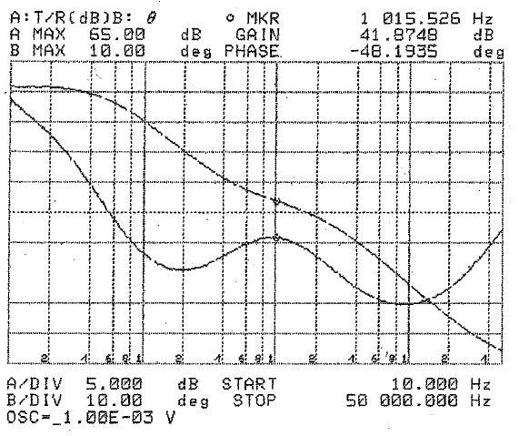

I was looking for 40 dB gain at 1 kHz - I got ~42 dB, which is close enough for the time being. The circuit is a fairly radical alteration of the Pacific preamp, with followers for each stage, cascoding, and extra current source biasing to allow the gain FETs to run at fairly high quiescent current and also to be able to more independently choose the load resistor values, as not all the bias current is flowing in the load resistors.
When all is said and done, I'll probably go back to using a simple cascoded 2SK170 in the first stage, as performance is adequate at the low signal levels there. However, the use of a heavily biased MOSFET and the extra current source appears to have a big advantage at higher signal levels, with about 1/10 the THD of a simple JFET source follower, according to simulation. This time around, though, I was feeling cantankerous and wanted to do the whole preamp with domestic FETs that could be purchased locally.
The schematic shows one channel and the common discrete regulator for both channels.
