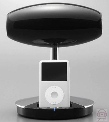

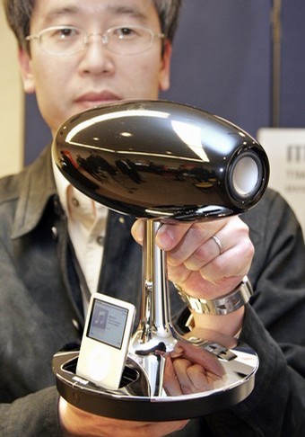

Hi!
the Time Domain licensed Maxell MXSP-4000 is based on the same principle as original Stereolith - the drivers for left and right channels are installed on the opposite ends of the enclosure
best,
graaf
