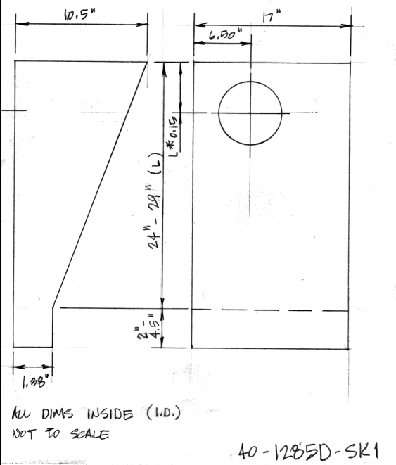

I built the 29" long version, but don't recall how long the final straight taper was, though probably 2" since it was floor coupled. Regardless, I designed it to either sit on the floor so that the mouth was floor coupled and tilted back if run full range or with a gapped baseplate if stand mounted and XO'd to a sub system since it was planned for an inexpensive HT system that became stillborn when RS decided to get out of DIY speaker building and the ~ equivalent car audio drivers were way too expensive.

If your specs are even ballpark (given that they were taken from drivers with a high variability and a different manufacture), they seem to need a large BIB. With your formula, I get a Vb of 8.147 cu ft. My ScottMoose dimensioned Hemp BIB's are 8.6ish. If it weren't for the considerably higher Fs of the 40-1285D's (my BIB's are L=150.5"), they'd probably work allright.

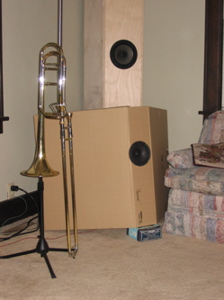

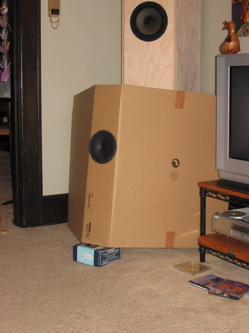

I got to thinkin' about the Qts, and lookin' at a pair of Ikea boxes. The result is below. The backs are open, with the exception of little corners for stability. Bass is pretty strong to 80hz. They sound pretty nice. They are fresh out of the box, so I won't judge much. Compared the the Hemps, the midrange isn't is warm and they sound smaller with less distinct images. I hear some peaks, but there are fewer problems than I'd expect. I didn't think I'd much notice that they don't extend past 12K, but instruments with high overtones (piano, violin, cymbals) sound considerably less real than on the hemps. I guess that upper half octave or so (I think I can only hear to 16K) really does make a difference.
I think I'm going to take 'em down to the basement for some breakin' in.
