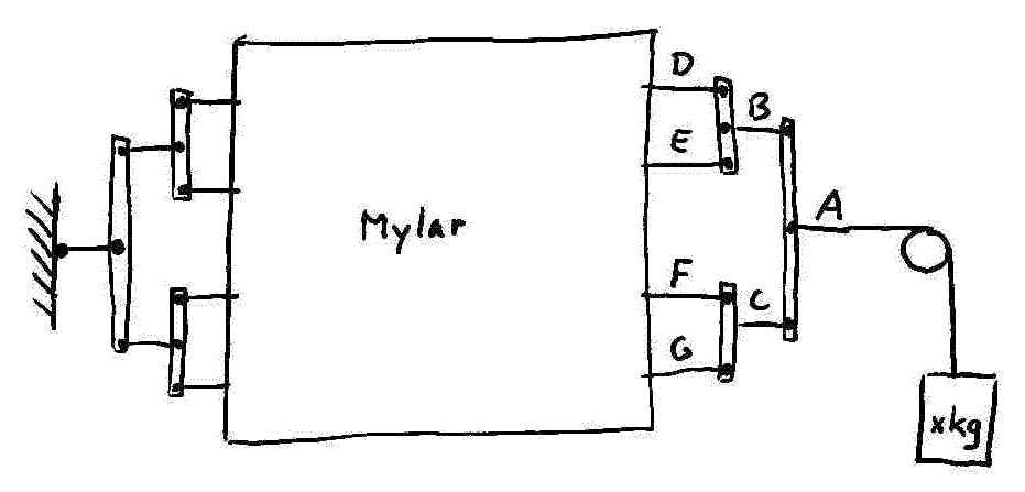

I wonder if you could have done with just half the weights though. Of course the "other side" of a weight should then have been clamped with a spring between the clamp and the supporting frame.
Come to think of it, when fitting a primary mirror to a (newtonian) telescope, we (amateur telescope builders) use a "floating support" (a pressure equalizing mechanism) to ensure that the mirror is supported equally on all contact points.
Like this: http://home.scarlet.be/~tsc84361/atm/my14inf5.html
(About half way down the page)
To improve on your design, something similar could be done with a lever system like in the annex. That way you would be guaranteed that the force pulling on each clamp would be the same. At least if the distances between AB and AC are equal and between DB, EB, FC and GC. Same for the opposite side.
(It goes without saying that you would need it for all sides.)

SkySeeker, I like your original ideas for modification, but I doubt they would be actual improvements. Your first idea with the springs would make the tension dependent on the actual position of the film. Intuitivly, I'd say this is a problem. Your second idea with the balancing rods, it might work but I think it will be quite difficult to use it. Envision your device and a formless thin film. How are you going to attach it properly?
But please don't let me stop you from trying! Post pics when you do 🙂

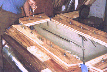

diamondsouled said:
Here's a pic of a Beveridge mylar diaphragm being stretched.
Pfffew, looks like a PITA to set up! I doubt they still do it that way.
The successor of the weighted jig that Quad employed for their ESL63 is a pneumatic driven device, using what looks like piano keys to stretch the film.
The picture is called 'coating' and it is said that this is what is being done by the man with the brush. I doubt it. It is clear to anyone who actually looked at a 63 panel that the coating is sprayed on. Perhaps this is the application of the secret incredient 'X' that was rumoured to be applied to the diaphragm by Quad.
I'm pretty sure it's not the 57. If you look closely, you can see the stator of a 63 element in a frame vertically on the left of the pic.
As can be deducted from the working of the machine, the stator is glued to the diaphragm from above. The coating on a 63 is on the other side of the diaphragm.
With the 57, the coating was brushed on indeed (on both sides of the diaphragm).
