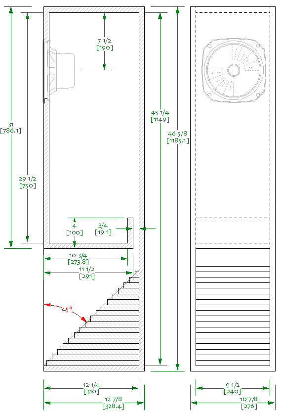

So hows does this enclosure work? It looks like a small reflex box with a wide port. The port aims down on the "bass tobaggon" and is thus reinforced. Is that right? The space behind the angled down piece is just dead space, right?
The tapered space loads the bass port, bringing the bass up, yeah?

Dave, I am sorry if I was not clear in my original post, what I meant was that it would be nice if Suzy chang style or design could be made in different sizes to accomodate different drives. I understand that Suzy chang could not fit Pioneer 8inch speaker, but was wondering if someone would suggest perimeters for larger enclosures. Curvy chang just seems a bit on a larger side. Honestly I wish I had space to accomodate. Neverthless, the simplicity of Suzy chang style seems as well quite attractive.
It's a reflex slot-vent with massive end correction applied. Makes a useful stand & waveguide too.
Yes, a version for the B20 is possible. Just take the Chang cabinet, remove the upper vent, and double the depth of the slot-vent firing into the lower flare. If you feel like it, raise the driver so it's centre is 190mm down from the internal top. Remember to brace the reflex cabinet or you'll have vibration issues with the larger boxes.

Scottmoose said:Yes, a version for the B20 is possible. Just take the Chang cabinet, remove the upper vent, and double the depth of the slot-vent firing into the lower flare. If you feel like it, raise the driver so it's centre is 190mm down from the internal top.
Half-Chang?
Like this?
