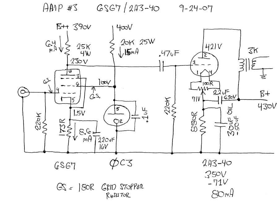

For my next amp project, I’m planning on a circuit similar to the WE91.
OK. It starts with a pentode, and that where the similarity ends.
The input/driver is a 6sg7 with a 0c3 to regulate the g2 voltage. The power tube is a JJ2A3-40 (300B with 2.5V filament)
Here are some specific questions, see the attached schematic.
1. Is the circuit for the 0c3 correct?
2. When using a 0c3 to set the g2 voltage of the pentode, do you need a capacitor from g2 to the cathode?
3. In general, is the 0c3 worth the cost (heat) of the 15ma it burns to regulate the g2 1-2 mA
4.For the pentode, I want an octal based tube, preferably glass. I’ve looked at:
6j7gt at 3mA (cathode)
6sj7 at 6.25mA
6sg7 at 8.1mA
On paper, the 6sg7 looks like the best choice, (lowest distortion, very high voltage swing, and the most current)
Any thoughts on my choice of pentodes?

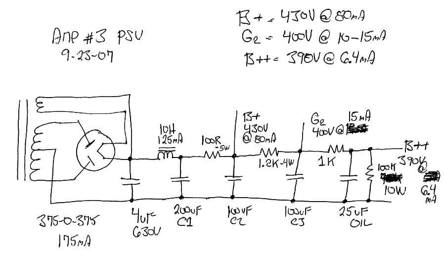

5. Is the power supply overkill…. IE the separate “g2” voltage for the oc3

I would probably choose the 6SG7 and then the 6SJ7 in that order.
Using an OC3 as a screen regulator is a great idea, shunting it with anything more than 0.01uF - 0.022uF probably isn't, at 0.1uF I would be concerned that the gas tube and cap will turn into a relaxation oscillator.
I would use a standard 300B rather than the JJ 2.5V version (2A3-40) as this will give you a lot more flexibility in terms of future tube choices. (And sadly JJ seems to be having some pretty significant QC issues with larger power tubes at the moment.) Using a 5V tube will require dc filaments (ccs recommended) for low noise - the one real advantage of the 2.5V JJ tube.
I haven't looked closely at anything else, but it looks like a reasonable starting point.
Edit:
I spoke too soon - I found some other things. (refinements mostly) The cathode bypass cap and the ultrapath cap ought to be higher in value for good bass performance. I'd recommend 80 - 100uF and for effective ripple cancelling the ultrapath cap should be sized using this relationship
C_ultrapath=C_bypass/Mu +1 in this case with 100uF a 20 - 22uF gives you a significant amount of cancellation of supply ripple in the output stage. In a similar amp I did a couple of years ago Spice predicted something like 20dB of additional ripple suppression and I got something > 15dB - a rather worthwhile improvement.
The quality of the ultrapath capacitor is quite important, I used a 20uF Solen with a 100uF ASC motor run as cathode bypass cap. A better ultrapath cap than the Solen is probably a good investment.
Gas tubes can be quite noisy, hopefully this is not an issue here, if it is a zener may well be quieter, and can be bypassed with a honking big cap if desired. Sometimes RC decoupling can be used, but R has to be small to minimize IR drop with varying screen current which means that to prevent relaxation oscillations the cap still has to be pretty small. It does establish a predictable HF pole which is a good thing.
You can't use a cap of meaningful size on the screen to the cathode or ground with a gas tube because of the oscillation issue, and in any case the source impedance of the gas tube is extremely low. You do need to make sure the cathode is well bypassed to ground for best linearity.
In terms of OC3 current you could probably get by with a little less than 15mA, but this or even higher current will lower the internal impedance of the gas tube. You have plenty of voltage margin so the tube should "strike" reliably.
I don't see any particular problems with the psu design, you might want to check it in psud if you haven't done so already..

Thanks Kevin,
I committed to the 2.5V filament for the power tube (custom made T1 on order).
So that leaves me with the Sovtek 2a3 runing at about 21 watts, take my chances with the JJ (that was original plan), or spend about $375 a pair for EML 2a3-s or KR 2a3.
I will change the 0C3 to run at 10mA with a .01uf cap.
What brand of capacitor would you recommend for the “ultra-path”… in place of the Solen?
Also, what do you think about just using the 50-100uf ultra-path capacitor and omitting the cap on the cathode bypass resistor?

I tried just the ultrapath configuration and found I preferred the two cap configuration, and with a single cap you loose the ripple canceling inherently possible with this configuration.
In terms of something better than Solen I was thinking the Clarity Cap SA would be one possibility, the Erse Pulse X another - both are available from a variety of sources like www.diycable.com, and Clarity from www.e-speakers.com The nice thing about these caps is they sound good and aren't very expensive unlike many other boutique brands out there. ASC motor run caps on eBay are cost effective and pretty good sounding in this configuration - a bit soft on the highs if used by themselves.

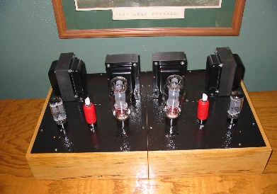

Sounds like a cool project, be sure to post details as it all unfolds, pix of course would be great.

Here is new schematic for the EF37A / 2A3-40 Ultra-Path amp. This amplifier sounds wonderful… I can recommend the 2A3-40 to anyone that wants the power of a 300B without the hum issues. I used AC heaters with hum pots for the 2A3-40’s and DC for the EF37A’s.
I started with about 3mV of hum before the ultra-path cap and the dc heaters on the EF37, now the actual hum is 1mV!

Hi Scott,
The proof of course is in the pudding.. 😀 Took a quick look at your schematic and your design looks good to me.
Since you are limited in plate dissipation I think your chosen operating point for the EF37A is a reasonable one. (Based on your schematic values, not the ones listed in a previous post.)
Power level and distortion are quite good, particularly when you consider this is a two stage design and the 2A3-40 is really closer to a 300B in drive requirements when operated at these voltage.
How about some pix of your new amplifier?

HI Sgerus,
Is your driver a 5842 or 5842WA? iirc the WA version will bias up higher, around 3V I think versus ~1.5 for the 5842 and I think you can actually get away with driving a 300B with the WA version.
I was using them (5842) on a SE 2A3 IT amp years ago when the 417 was all the fashion but the 5842 was cheaper.
I still think it is a good driver once tamed.
The 6c45 is also a candidate but I think is even more prone to oscillation.
I would have thought you would have more bandwidth on the top with the 5842 although it would be just semantics in my case as I can just hear around 15Kcycles or could anyway last time I checked many years ago.
What opt's are you using?
The JJ 2a3-40 are beautiful to look at. Did you compare them soundwise to any others?
Are the EML's and KR's still manufactured or NOS? I did not know they were still around as I have not heard of either of them for years.
Thanks for the update on your project.
