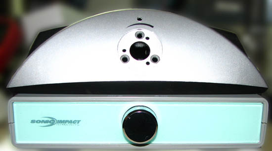

First Look at GEN-2
Got one today. Nice little box. About the same size as the original Sonic. Still all plastic, but not nearly as tall. Thinner and deeper.
And it comes with a power supply! Ah, ha. That's where the higher price come in. Same style of 12V SMPS as comes with The Super-T or the Trends.
New amp has the same cheap little spring clips on the back for the speakers. Not the worlds best, but meant for a small portable amp like this. Good binding posts might weigh more than the whole amp.
Same 1/8" mini plug for audio input. Battery compartments on the sides underneath, just like the first one. 8 AA batteries.
Here's an odd thing, it has a headphone jack! I don't know yet how it's fed, it may simply jump off the input.
You can see the photo below with an old SI case on top for comparison.
