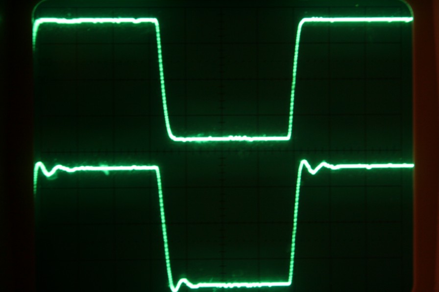

I'm designing a 200 watt bass amp using a quad of KT88's in ultralinear configuration. I'm looking at Hammond output iron for cost / performance reasons, particularly the 1650W rated at 280 watts at full power bandwidth down to 30 Hz. At 28 pounds its a monster. I was also looking at the 1650T with the same PP impedance (1900 ohms) but rated at 120 watts, at only 9.5 pounds (not the 14 that is listed on Hammond's site).
I know people have pushed the 1650T to over 150 watts, and Kevin O'Conner has a 200 watt guitar amp in is Principles of Power book using the 1650T. I'd guess that would be fine for guitar, but not for bass. I was thinking of the possibility of paralleling two 1650T's (primaries and secondaries) which would keep the turns ratio (and therefore the impedance) the same but would effectively double the power handling and maintain full power bandwidth to 30 Hz. The seeming advantage? Price for two 1650T's is about the same as one 1650W, total weight would be around 19 lbs vs 28 lbs, and even though they would take up a bit more chassis space than the 1650W (not by much, as I said the 1650W is a beast), you could balance the weight on the chassis with the two.
Has anyone tried anything like this? I saw that John Broskie had a blog about paralleling output transformers from Dynaco ST70s to make a "super" Dynaco ST70 so I figure the idea is not too far fetched:

Are you able enough to lift it ? By the time the mains tranny is fitted you will have more than double the weight and the chassis be strong enough to take settling down thumps.
There is nothing wrong with the power tact except over 530V B+ with modern day KT88's is going to stretch them. Going for a triple per side push pull would relieve but one would up the heater current supply with larger chassis size but with more o/p tubes will tax the performance of the interstage driver. where quality isn't a issue then it doesn't matter.
Paralleling output transformers is fine (As Broskie points out) so long the specs on each are fairly sim. Any problems would come apparent at higher frequencies, as circulatorary leakage inductance / capacitance parasitics become a conflict pest. At the low f end it wouldn't be noticed and in fact many amp builders have used standard mains transformers frequencies under 500Hz. Other builders in this forum have done this.
Generally for hi-fi it is better to lower the primary side working impedance (i.e fit more tubes) which lowers parasitic problems which increases the bandwidth whereas your suggestion would not.
I use 2K A-A UL 43% 10Lb lump made by Majestic which can hull 175W at 20Hz but needs over 530V B+ to get it. The mid and bass range is incredibly forceful and dangerous. With KT88's running at this voltage with 60mA Iq per tube and 130mA on peaks, the remaining ability is on the power supply to hold up 0.75A on power peaks.
The other possibility is to build a normal stereo amp and power bridge mode the outputs by using a phasesplitter in the input. Anyone done this ?
Changing ideas, this enables you to simply revert to a standard stereo version at virtually nil expense.

hey-Hey!!!,
Getting 100W/pair of KT88 is a bit of a stretch. I'd suggest a larger single pair of valves. 813 perhaps? How important is the 200W spec?
Multi-parallel pairs risks oscillation. Nearly all of the commercial stuff I've looked at has at least one countermeasure, most have a few. Extra care is certainly required for that sort of topology.

Umm....I've done alot with multi-parallel p-p pairs without instability problems. A KT88 is more likely to oscillate than others.
What I intended to mention is that B+ 530 V in UL is pushing it with todays KT88's. Nachbaurs design uses direct coupling the output stage to driver and running from neg supply risks Iq drift problems if driver tubes get fusty. It is this that I still prefer separate tube setup bias pots with coupling caps. This is entirely desgners preference.
Any method of running tubes at lower voltages which prolongs life is a must in these tube expensive days. The annoying problem of trying to use a single electrolytic for the B+ instead of series/parallel arrangement would make psu things simpler. Still, simple design using a single 500V electrolytic running at 450V with a parallel pair of 6550's in UL 2K A-A gives touch over 100W, so it isn't so difficult to get more output with an additional pair.

Gerryc ..there's a catch with all this poke.....the power supply needs some thinking over. The one shown with that GEC amp can be bettered with SS. Do you intend using amp with global nfb ?
Looking at the output tranny with 1.9K A-A using 2 parallel pairs you will be shy getting 200W with 530V B+ , see following example below. That's too low Z for 2x KT88's per p-p side, So that implies 3 tubes in each p-p half for generous no sweat operation.
Prim Z = turns ratio squared x LS Z; from this one can get the min
prim-prim AC voltage = tot Pri/sec ratio x Vout (LS) assume into 4 ohms
So fiddling the formula gives 551V = 19 X 29
or Prim Z = 19 sqd x 4 = 1.44K A-A. This figure falls bang-on for optimum power transfer with 3x KT88 tubes in each p-p half.
In design most figures rounded up to suit combination secondary windings i.e 4/8/16 ohms.
If you want to run at 500V B+ then formula says a turns ratio of 17.5 which gives 1.2K A-A....again 3 KT88 tubes per side.
Of course, all the above done roughly on the back of my hand.
One can see that any change in ouput voltage between 24.5V and 28.5V is small but in power equals 150W vs 200W.

Rich, I see what you're saying. If I want to use the 1650W at 1900 ohms I have turns ratio of SQRT(1900/4) = 21.8. Primary RMS voltage required is 21.8 * 29 = 632v. Half the primary voltage is 632/2 = 321 and the peak is 316*1.414.. = 447v pk. I read somewhere that the saturation voltage for a KT88 is around 90 volts (I assume that it doesn't change if you parallel them), so if that's correct, adding that in gives 447+90 = 537 volts, so it looks like it would require at least a 540 volt supply under full load, maybe a bit more for 200 watts into 1.9K, using as many parallel tubes as necessary to supply the current (I'm assuming three per side as you did). Does that look correct to you?
Answering your other questions, yes I'm going to use a SS supply as stiff as I can reasonably make it. I also intent to use a modest amount of global NFB but haven't gotten that far yet.
You'll need it as the distortion will be quite high, too much for bass. O/P Z will be significant as well.gerryc said:I also intent to use a modest amount of global NFB but haven't gotten that far yet.
Yup.....it looks right.-Others looking at this thread with a view to designing HP should now see the combination limitations of high B+ and UL. At the monent it seems the dice has rolled to the advantage of tetrode operation when it comes to B+ and a fixed prim Z at the expense of higher output Z.. Going to an exotic custom made o/p tranny is expensive.

Great discussion. Yes, it's becoming obvious that to get high power using standard (not exotic or transmitting) tubes in UL with good reliability requires reasonable supply voltages with parallel output tubes and a low enough output transformer impedance. The latter unfortunately requiring something custom, having a lower than typically available P-to-P impedance. Off the shelf transformers like the Hammonds "bottom out" at 1900 ohms so one can only do so much with parallel tubes without raising the supply voltage.
Bottom line for my goals is probably living with reduced power so as to maintain a reasonable B+ voltage, or go tetrode and control the plate and screen supplies separately. Separate screen windings would be great here, but that's most likely a custom transformer. Oh well...
In your position, build and expect for KT88's and retrofit KT90's. That leaves one a bit in reserve.

I did look at the DePalma schematic which uses UL as sep windings at lower screen voltage and lets the anode rip at 600V. The completely balanced phase splitter idea looks intriguing but is it really necessary ? No (OMO)M; global NFB sorts out any misbalance and I don't like presets other than setting o/p stage bias.
However the DePalma configuration requires another PSU to run the screen which deters me from using it. O.M.O, I don't like complicated o/p stages. The other problem with UL operation which tends to get ignored that the screen is a natural tap on the primary, so it has a poor coupling factor and high leakage inductance relative to it's anode, so it will overshoot and ring with rising frequency. Sectionalised anode and screen windings wound within sectionalised secondary is an exotic luxury makes matters more complicated.
In reality with more modern transformers one has to put a snubber from p-p screen to screen as from screen to anode on each side. Photo shown with and without. The correction is quite perfect.
