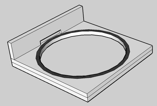

JohnInCR suggested that I extend the rear of the ripole to form a U-baffle extenstion. I plan to do that later via a sliding sleeve.
Excuse me while go puy some plywood 🙂

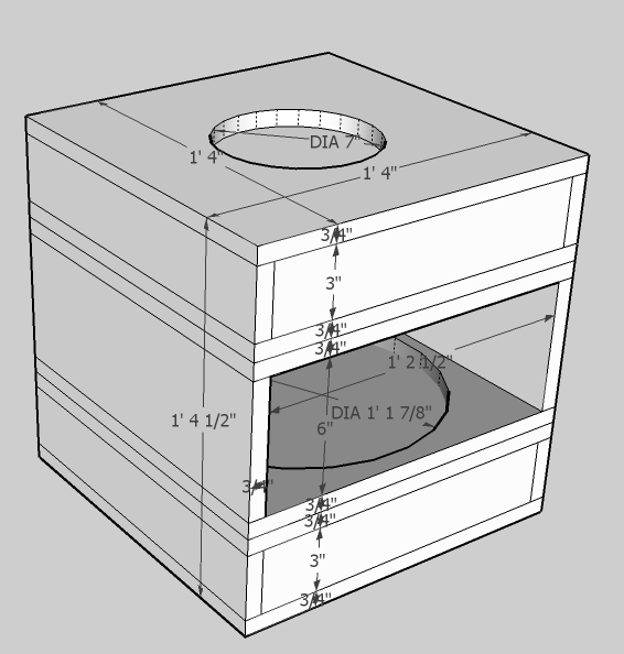

I've adjusted my dimensions slightly, since the plywood in the store is 48" wide, . not 49" like I had expected it to be. I'l have be rebate away a little wood to allow the driver to fit

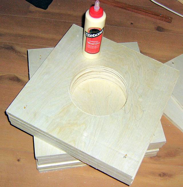

This is what I'll have to do to make sure the driver frame fits . Ths top part won't be glued in, but will be held in place by threaded rod .
Calvin, I'll wait on your simulations and build the baffles in the mean time. I thought I followed the rule of thumb correctly ie.

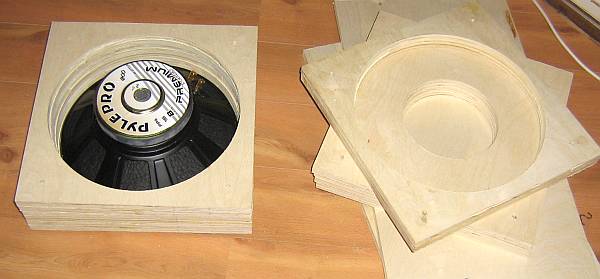

Nothing exciting yet, .. merely cut the panels to size and routed out the magnet pass-through holes. If you can keep the dimensions of the panels to just a little under 16", you should be able to build a pair of cabinets out of one 4 x 8 " sheet of plywood.

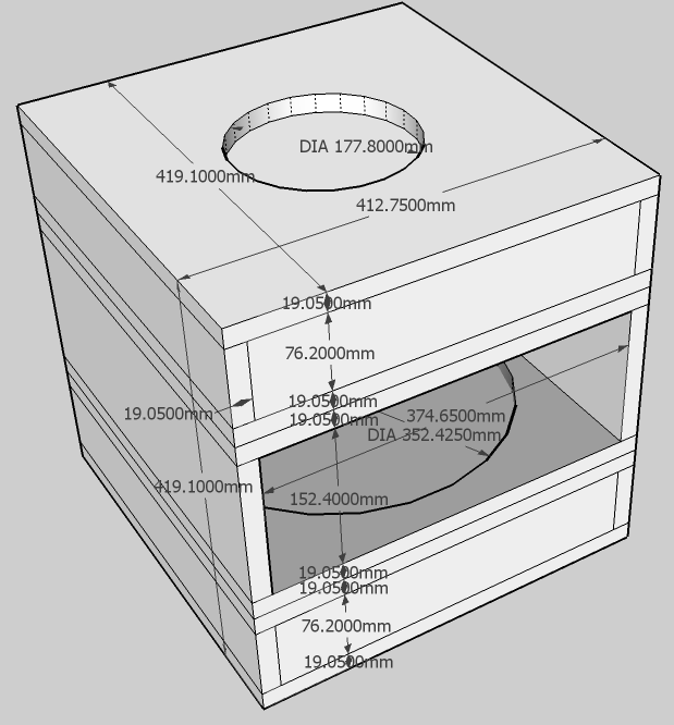

After cutting the square wood pieces down, trimming them to size etc
The realistic central compartment interior dimensions = 368 mm (W) x 387 mm (L)x 152 mm (H)
The 2 rear compartments dimensions = 368 mm (W) x 387 mm (L))x 76 mm (H)
I haven't cut the pieces of wood that make up the height of the individual compartments (the H pieces) so let me know what you think are optimal sizes (and why). For my initial estimates, I used Srear = 1/3 x Sd and Sfront = 2 x Srear (dual ripole)
From your post, I think that excessive driver loading will be unnecessary for these drivers since their Fs is low to begin with.

In any case, I rigged together one last night with the side pieces pressure fit via threaded rod . I'll try and get some impedance measurements later tonight so we can see what's going on.
Subjectively, this thing is INEFFICIENT Agreed, all I have for now is a 100 W power amp (Mcintosh 2100)driving it fed off the LFE of my reciever, but I've had to max it out and at that point, it's subjectively just about able to keep up with the efficient arrays. The pure dipole seemed to work with the gain turned up around half as high. I haven't rigged up the 2nd ripole yet, .. those drivers are in the MDF board for now.
The bass is subjectively clean (though I think) the pure dipole bass has better attack . The ripole doesn't pressurize the room and is subjectively even ie. no annoying peaks, it's clean. Good for music. Individual notes on the bass / synth are well defined. Cone motion is evident but seems somewhat less than the flat dipole. SPL measurements seem fairly flat down to Fs taken at the mouth, ... but drop off in the 30s when taken at listening position. .
Big disappointment for home theater effects. Explosions are wimpy sounding. I was expecting a bit more in the "sock you in the chest" department. I'm guessing that this isn't what ripoles are designed for, though. It could also be that the motor isn't strong enough for a ripole, as suggested earlier in this thread.
Dimensions are similar to my sketchup models posted earlier in this thread. Maybe I should change those dimensions. Any suggestions?
The neat thing about the way things are set up right now is that I can easily change this to a linkwitz type W-baffle or a ripole of different dimenstions by cutting up new spacers (side pieces). I'm wondering if I should decrease the ripole loading.
