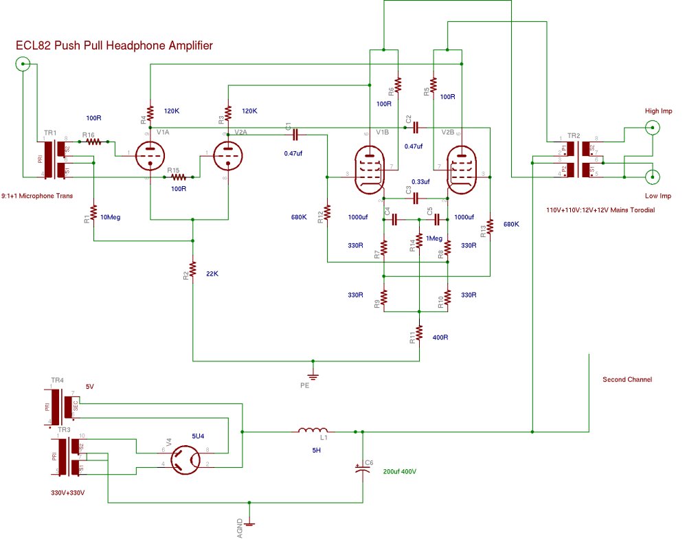

So heres the schematic.
Still got a small amount of 50hz hum - equal on both channels and just noticable with nothing playing. Any ideas where to start looking for the source. Have the circuit earth isolated from mains earth by a 100R resistor paralleled with back to back diodes and a small cap.

I'm not sure about the 50Hz hum but your B+ supply doesn't look incredibly well-filtered... maybe another LC filter with a higher value choke might help, but you didn't say you had a problem with buzz.. did you wire the output tubes out of phase?
I had the cathode wires a little to close to the heater wires. After I moved them a bit the hum reduced. Its still there, but now has the quality of background fuzz. Its so small that I have decided not to go after it.

Hi Shooq,
What output tube did you use?
How did you choose the 500uF between the two cathodes?

Glad you spotted that the effective value of the bypass cap was 500uf and not 1000uf. To be honest I chose them based on what I had in the parts bin. You can derive the correct value by doing a standard cathode bypass calculation and doubling it.

That is certainly an interesting circuit and even more interesting seeing it in the context of Alan Blumlein, whom I seem to be crossing paths with frequently these days. Does this garter design genuinely balance current in as effective a manner as a servo?
I can only point you to the tubecad article where he does a test with grossly mismatched tubes and gets within 20% (I think). The man was a genus in an age when engineering was respected.
It works and works well. If it didn't I would be experiencing massive power supply hum as the power supply is very minimal. I am so impressed that I am seriously thinking of using it over Lm317 CCS in my Tabor clone. The only downside is the need to burn up twice the bias voltage. Since in both this design and my Tabor clone I need to burn up cathode voltage to get it to work - it suites me fine. Of course nominally a LM317 CCS should perform better on paper at least, but resistors are more robust and don't need heatsinks.

True, it's CMRR is strongly in evidence if it is cancelling hum from your admittedly minimalist power supply. That cross-coupling of grids to cathodes shows up in Western Electric designs. I hadn't heard about the Tabor but now that Gary Pimm has taken down his website it's not possible to find out much (and it was never particularly well documented.) Are you using 1624s in your Tabor clone?
No I have a rake of 807's (electrically identical but indirectly heated) so thats what I will be using. Just waiting for the bases and some 6AU6's. I have great hopes for this design.

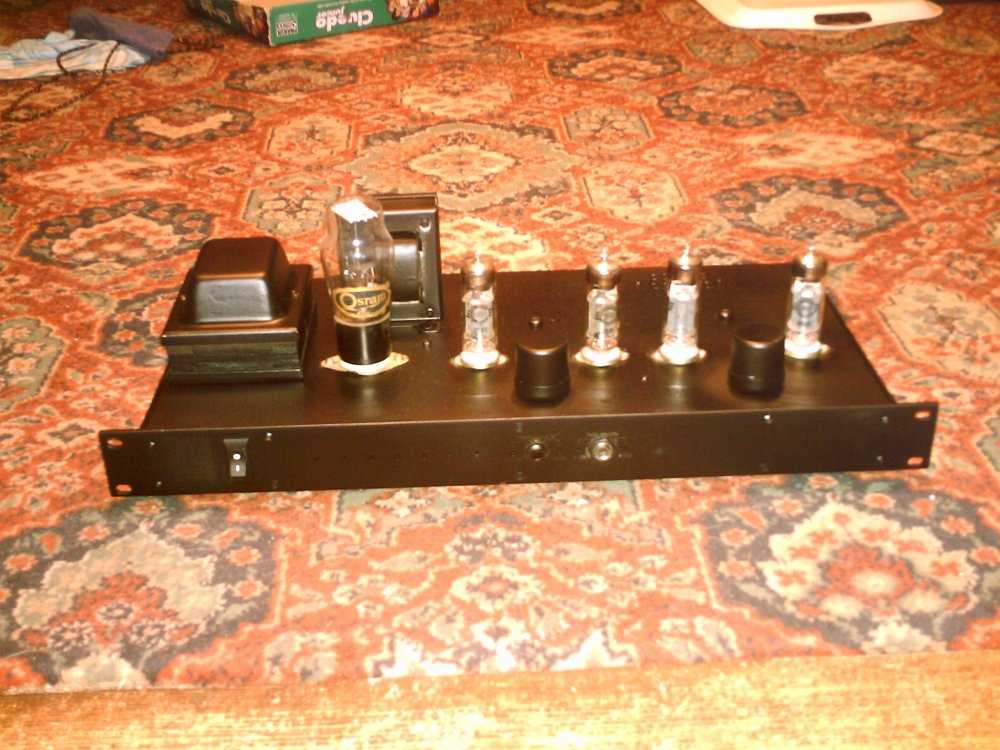

I finally got sorted with my daughters digital camera (added Ubuntu for handling the camera - couldn't as yet get Suse to recognise the USB card reader I have
So heres a picture for your delectation.
