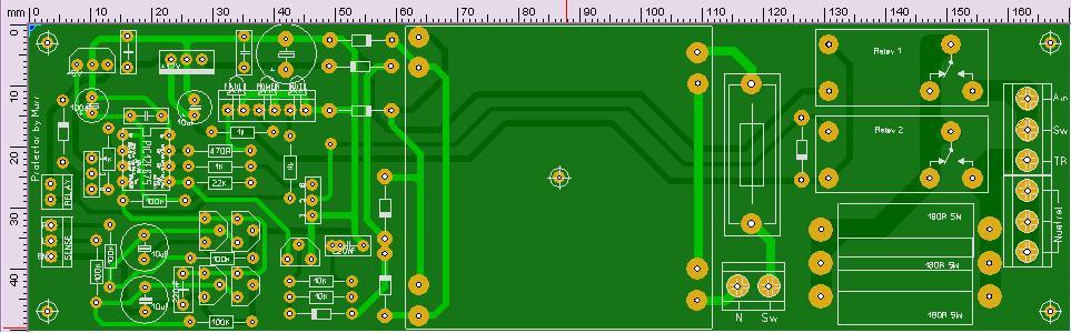

I decided to mount all of this on the one PCB. The resultant PCB has all the ccts and small PCB toroid on board and measures 170mm x 50mm (the toroid is 50mm x 50mm).
This mainly because my monoblock cases will be 75mm high so the long, thin PCB will be best fit.

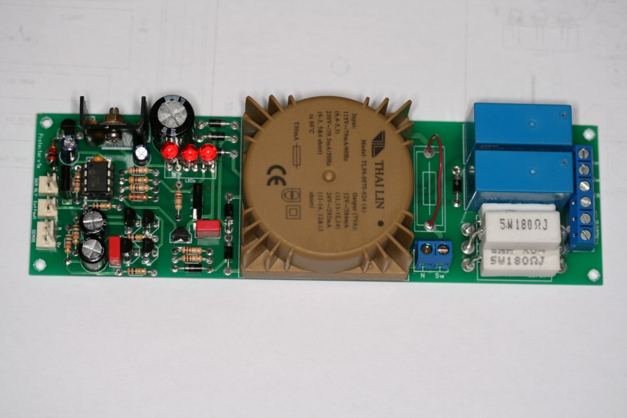

First one built
The PCBs arrived and I have built one of the units so far.
Tested this one and took traces (storage CRO) of the switching to ensure all worked as it did on the breadboard.
Works as expected.... It's all good... I'm happy 🙂
I had the three LEDs (I used red for all in testing) mounted on the PCB... there will be a 6pin header there for wiring to the LEDs at the front panel eventually.
Only item missing is the fuse holders (plus need to buy another toriod for the 2nd board.... will get these during the week some time.
Project complete.

The Zristic Protector
Nice one, love PIC driven stuff.
PIC noise on audio circuits:-
Have done several PIC ccts within audio and have almost never seen any noise. The only occassion I have seen anything it was theorised to be related to the oscillator section.... earthing the crystal can solved the prob completely...in that case there was a layout issue ith the PIC section adjacent to the gian stages.
In mine I am using the internal osc so no issues.... I just waved the cro across the Speaker inputs on the DC detect to confirm.
Will be interesting as I have redesigned my preamp PCB. Was a collection of PCBs mod'ed over the years. Had an ALPS motorised pot on the main PCB with another little PCB with a PIC decoder/controller. I have it all on one PCB now but have not built it yet.
Did not include optos as previous experience had never required these.
Will be interesting to see how this goes.
Soft Start duration:-
0.7-1.0 seems like a very long time... depends on transformer size, but, a lot of current. All my Googling and searching suggested 100mS.
The other SoftStarts available (incl the ESP one) all use around 100mS.
My testing showed a minimimal glitch on the mains using 100mS, longer did not make much of a difference. Sorter time puts less stress on the resistors as well.
Anyway... that is the beauty of micrcontrollers....easy to alter these sorts of things.
One suggestion:-
Try adding a zener in series with the Speaker Relay EMF diode (Anode of the 1N4148 on one side of the coil, Cathodes of the 1n4148 and zener connected together, anode of the zener onto the other side of the coil) this will speed up relay release by around 40%. The BC548 Vceo is 30v so a 20v zener would be good. Although the higher the zener value the better (faster release).
I like to use DB681's their Vceo is 100v so I use 27v zener (plus the one device will drive at least 6 relays).
Keep up the good work.
