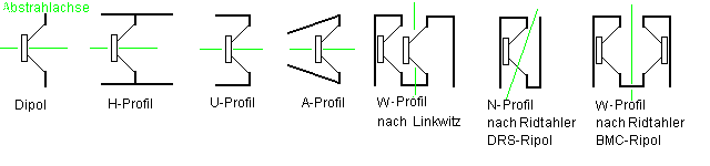

What's the difference between the linkwitz W dipole and the dual driver ripole (apart from driver orientation)?
Isn't the ripole somewhat smaller and doesn't it in some way lower the Fs of the driver due to the way it loads the driver?
AFAIK, a dipole doesn't do anything to the Fs and doesn't really load the driver at all.
The Linkwitz W dipole tries to cancel non-harmonic distortions by running the drivers push-pull. But the construction leads to front and rear air volumes that are very different for both drivers. So symmetry in frequency response is questionable.
The ripole favoures driver symmetry. Usually ripoles load the drivers by minimizing the front cavity. This leads to a lowered fs and transfers the onset of the dipole roll off to lower frequencies too.
In some way the ripole approaches a dipole made of two very short transmission lines while the Linkwitz W is more like a folded OB.

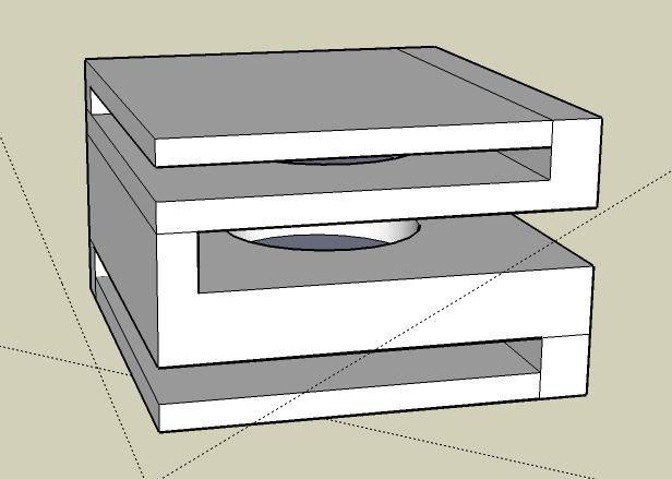

Do you mean like this (see rough figure) aiming to satisfy the following criteria:
1. minimize the center "common" chambers
2. ensure that the sum of the heights top and bottom chambers are equal to the height of the common chamber
3. ensure that the height of the top chamber = the height of the bottom chamber

All three, though I'm not sure you want to minimize the "common" pathway, since you could make it too small. With my thin mounting plates the thinnest possible was a little big, even with holes in the side panels for the 2 outward magnets to poke through (an added complication and detraction from beauty.
In your drawing the 2 mounting plates are different thicknesses and you definitely don't want that, because everything won't be symmetrical.

Isn't a ripole pretty much the same thing as an N-baffle (half of a W-baffle), but with the front and rear walls closer to the woofer to build up a little bit of a load on the driver, effectively lowering the Fs some? IOW, isn't a ripole a smaller, narrower, more compact N-baffle dipole?
