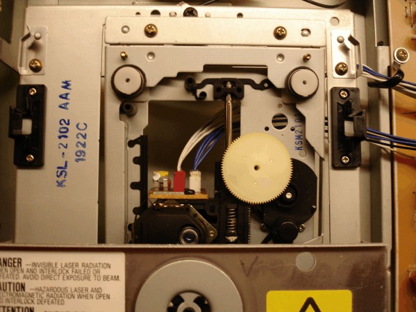

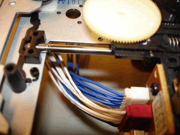

Finally I got time to get a closer look into the problem with my DX-703, and others may benefit from this.
Before ordering a new motor, I thought that I would try some of the suggestions from this and other threads. I disassembled the drive and lubricated the motors with very thin oil.
Sadly this didn't help, and I could see (and hear) the tracking gear trying to focus the laser. Then I lubricated the rod (same thin oil) that the laser slides on, put a disc in and selected first and last song a few times to have the oil spread over the hole rod, and now it works just fine. No noise from the tracking gear and no jumps 😉
The motor may be worn down, and may need replacement sometime in the future, but for now it has played several hours without any problems 😀
