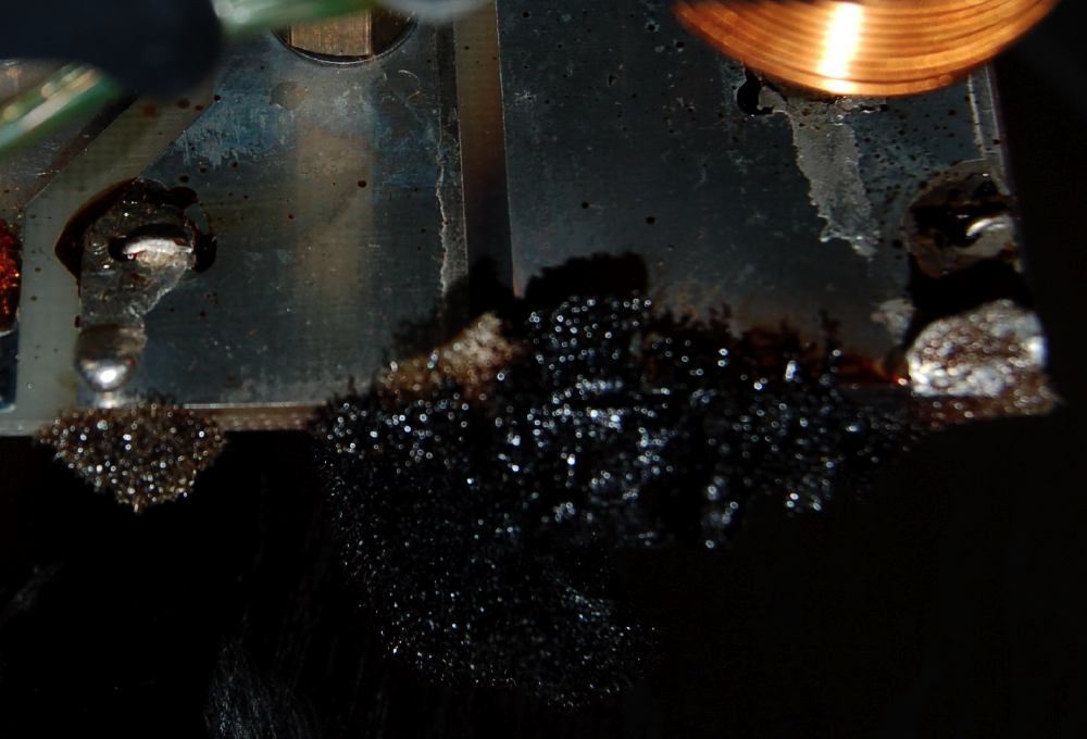

Here the resistor appears to belong to the tweeter and that end is burnt !😱
However the coil at the other end also got hot ! DC after breakdown due to oscillations ? Burnt components is something but a burnt pcb like this 'really' something else !

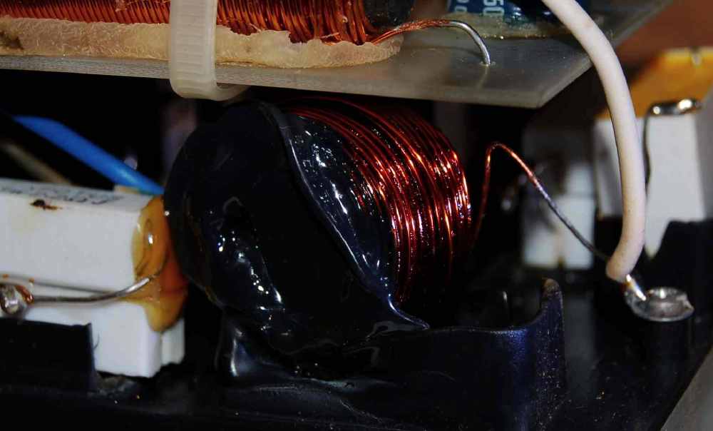

My son is removing the drivers on one speaker so I can test them. Here's the other crossover, showing burnt foam and the solder that ran down to the bottom of the board in two places. Remind me again how I'm measuring te drivers with my Fluke DMM? I assume I have to clip the two leads off.
Remove at least one of the driver wires, then measure across the terminals using the ohms setting on the dmm. You are looking for around 4 - 8ohms. If it is open circuit, ie the meter does nothing then it is blown.

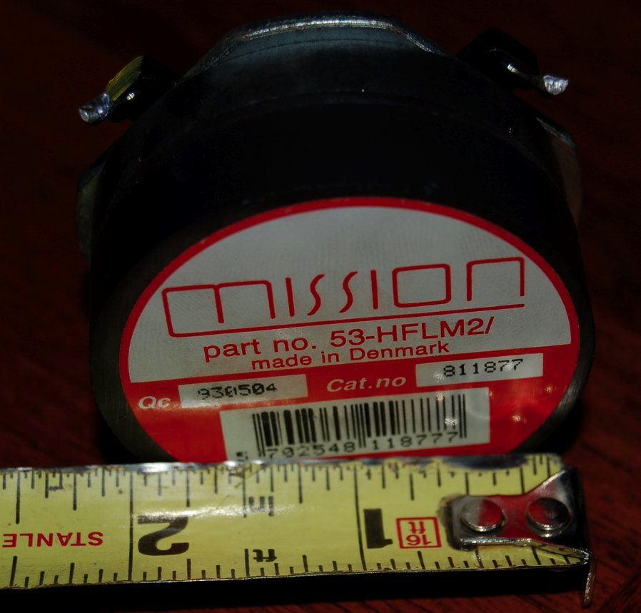

Yes, looks like tweeters are shot at well, where do I get replacements? They have what looks like a Mission part number 53-HFLM2/. Thanks again for everyone's help.

Looking at it the crossover look as as if it may be saved. The resistors are fried sure, but other than that the rest looks OK.

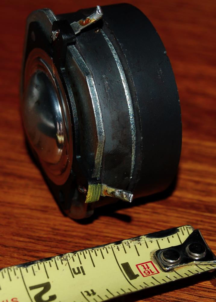

Here are a few piccies of the tweeter assembly.
I dont have one with the dome disassembled. However to describe briefly
The dome is not attached to the magnet assembly with screws or anything. The rectangular faceplate has a set of four clips. You just prise them apart and the assembly disassembles in your hand. The clips of the faceplate match the lugs that you can see in my last picture.
The whole that is left on the cabinate is a recessed rectangle with a circular hole routed out of it. The circular hole has a flat bottom however, extra space has been routed for the cables to the tweeter.
You might get replacement parts from mission themselves if you e-mail them.
If you have the non freedom version with the metal dome you could enquire about getting the silk dome as an exchange. I would think that you would not require a new magnet assembly, but I am unsure wether the magnet is different between versions. The metal dome version is sharper than the freedom. The freedoms are to my ears a little soft. The metals are quite harsh but can be improved upon for £0 outlay.

ashok said:Here the resistor appears to belong to the tweeter and that end is burnt !😱 .
FYI The top board does not control the tweeter. Thats the low pass filter for the bass assist woofers.

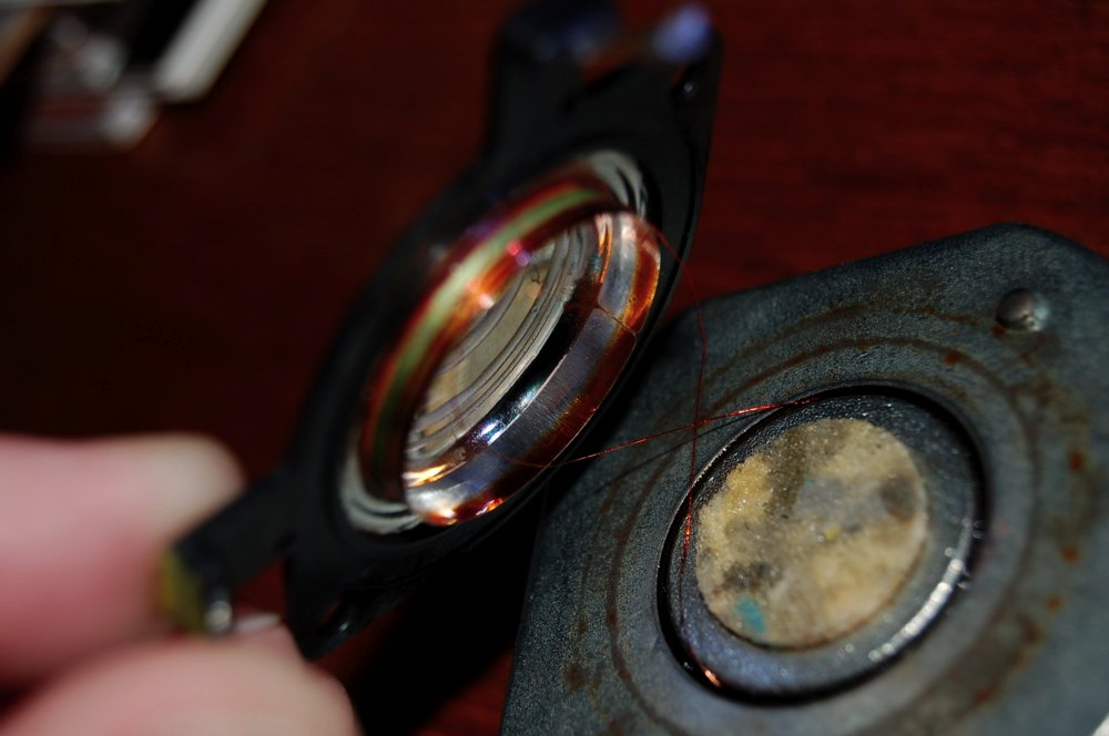

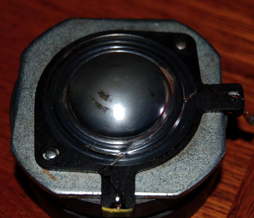

For the tweeters, they are the same as yours and I believe they are Vifa but could not find a current model that looks like this. Here are some pics. Looks like the coil is fused to the magnet because when I pulled it off it started to come unwound. Also, the outer metal shell looks like it was in contact with the outer dome screen, and you can see what appear to be abrasions on the outside surface of it. Is that oil that leaked out of the magnet?
So I guess I need a source for the tweeters, but don't know the original model or its specs so if I have to substitute a more current model and make it fit physically I'd like to not have to mess with the crossover. I guess I'll contact Mission as I doubt I would be able to find tweeters that would just fit right in.
