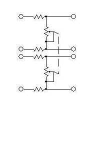

Hi Sangram,
I need to have balanced output (difficult to make 4-way stepped attenuator, plus it's very convenient with remote KB and mouse).
This is off topic and not for a discussion in this thread, but you dont really need 4-way stepped attenuator. The setup in attache schematics works perfect and saves you $80 🙂
