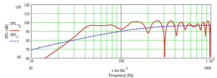

Just finished horn modelled with MJK's spreadsheet. The internals are similiar to Olsen's dual waveguide horn that starts out as a series of split manifold's which empty into a main horn section. It sounds as modelled (Definitely getting into the 30's) although I have not measured its response yet. Some design goals I had were nearly square mouth (438mm x 434mm), 1220mm H x 536mm D x 470mm W, .85xSd throat, Exp-Hyper flare T=.45. I even found a good deal at lowes for ply that is maple on one side and birch on the other and made the uppersection maple and the mouth birch.
One question I have though and it may be my error is that it seems the T/S parameters really don't effect the analysis in the worksheet. Am I doing something wrong? Iam using the FF225K now but want to try the FE207.
I doubt you're doing anything wrong (although I'd have to see your inputs to be sure). If you want to run a quick check, stuff the Visaton B200 T/S specs. into your model. You'll be much more likely to see a difference with this unit, as both Vas and Q are relatively high. As a general rule, hybrid BLHs are often quite forgiving of moderate driver changes (though they'll usually work better with the unit they've been optimised for).
Thanks Scott. I'll give that a try. Since I had the FE207 handy and it was an easy replace, I figured why not. The differences are subtle but unless I am imagining things it sounds better than the FF225k as far as clarity and low end.

assuming half-space that looks pretty close to RCA Fan's 186 liter air-volume BLH sim.

You'll probably get better LF clarity as the 207 has 5 times the liner excursion of the 225, so you'll be getting less distortion down there. That said, it proves the 225 goes past Xmax quite gracefully, as you imply they still sounded pretty good.

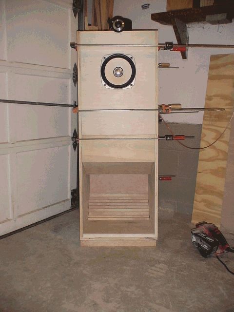

Here's the split section prior to the convergence into the main horn body. I opened up the throat to .85xSd. One strange thing I also notice with this horn vs. my first horn is that the other horn seemed to suck the life out of the speaker. It lost alot of its midrange. Now these sound alive.

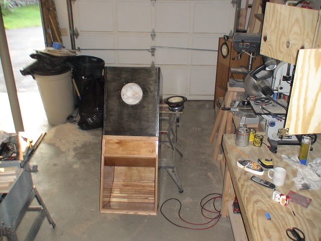

I know this might sound like a woodworking question but I am looking for advice. This horn looked really nice when it was white maple with the birch mouth. Last night I put a black ebony stain on the white maple portion and I don't like it. Is there any way to get the stain off? I know if I sand too much it will probably remove the finish since it is ply. Or am I stuck with it?
If the maple is ply then you are probably stuck with it as the stain most assuredly penetrated the first ply layer. If it's solid maple you might be able to sand it out but you'll have to take off a fair amount of wood to get down to a consistent, clean level.
seal it well then veneer it using an adhesive compatible with the sealer. much less work than sanding 1/8 of an inch off the inside of a box.
Since I couldn't turn back easily with the stain I decided to do the best I could and actually, it doesn't look that bad after the poly coat. These things are heavy (120+ lbs.) so I'm not lugging them out side to measure the response anytime soon. I have replace my FE208 enclosures and notice a significant difference. They seem to respond as modelled. I am definitely reaching the mid 30's. I have a question though and it wouldn't be possible without Scott's advice. I purposely made the throat and mouth so they could be tweeked. I am not precisely as modelled and was wondering what the best approach is to tweeking. Should I go back and remodel with what I really have and see how to improve? When I built the throat opening I made it a series of blocks with a bolt so I could increase or decrease the size. I also have the mouth low but could curve it slightly upward and dcrease the mouth. Any ideas?

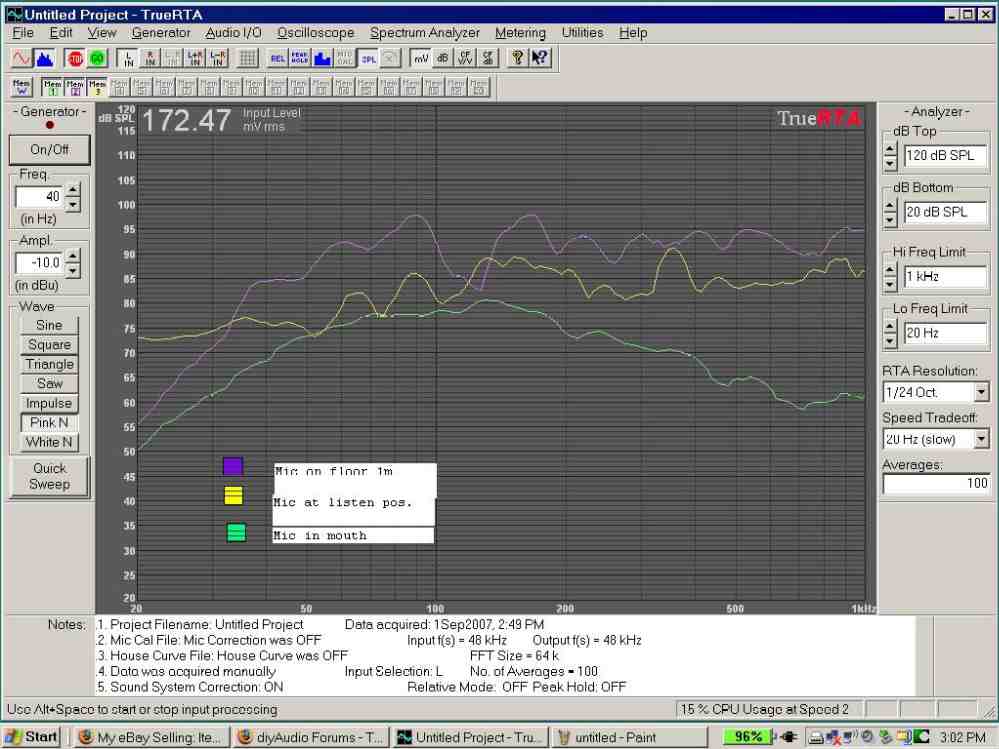

I measured the response as best as I could while they are in the room I listen to them. I really don't know if this data is even of any use but I came up the attached. It has a measurement in the mouth, one meter away on floor, and at the listening position. What's really strange is the listening position graph since it seems to be level from 20-50Hz??? Is this useless data? I also know the mouth does not have that much midrange output. I'm guessing the most accurate of the three is the mic 1m away on floor which seems to have some similiarities to what was modelled. Should I lug this thing outside if I really want a useful measurement?
Harry Olson would've been proud of you. 🙂
Well, given that you were measuring in-room, they actually agree pretty well with the 1/2 space graph IMO. As you say you're not precisely to the plan, I'd re-model the cabinet you have for interest. As it happens, I doubt that there will be huge differences, but it's always worth taking another look at things. You can check a few basic tweaks out in MathCad while you're doing it, but there are things you can do the software doesn't account for too -a run of damping material around the mouth etc. (something GM mentions).
FWIW, I'd say the plateau 50 - 20Hz is either a room-mode (probably), or a measuring glitch -depends how you measured them. Does it actually reproduce ~20Hz tones?
If you want a more accurate set of measrements in re their 1/2 space response, you'll have to lug them outside I'm afraid. Then again, it seems a bit back-breaking, and as you don't actually listen to them in 1/2 space (does anyone?) & AFAIK aren't planning to sell & market the things -why bother? Unless you're really into the science side, the important thing is how they sound in the environment you listen to them in, & those measurements look pretty good to me for that location.
