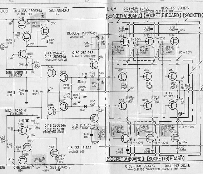

Sony TA-N7B VFET Help!!
Have a Sony TA-N7B with three (3) bad VFETs in one channel. The bad 2SK60s are rank JG-25 and I need two (2) of them. The bad 2SJ18 is rank JC-26. Am having trouble (surprise, surprise) finding the correct replacement parts. Thus far I've found 2SK60s with the rank of JG-34 and a 2SJ18 with the rank of KY-54. I believe these rankings are too far from the others to be useful, but would appreciate a better explanation of what will and will not work in replacement part rankings.
In addition, I have located six (6) pairs of Sony's 2SK82/2SJ28 VFETs, all rank KE-33. I am wondering if these larger VFETs from Sony's TA-N88B amp would work in the TA-N7B and what it would take to make them do so.
Any help would be greatly appreciated.
Thanks.
Right here!
Not sure if the JG-34 and KY-54 rank VFETs would be a problem - it is imperative that all the 2SJ and 2SK have the same rank between them. Since the TA-N7B works in an auto-cascode arrangement with it's output BJTs, the distribution of heat between the BJT and VFET in a cascode changes a little, but the total remains the same. Since they are all on the same heatsink, you should have no problem. The rank (pinch-off voltage) also influences how close the output can go to the power supply rail, hence influences maximum power, but not greatly. With higher pinch-off voltage, you lose a few W of output power, however, you should have no problem staying well above the declared power output as it is quite conservative. Now, take this with a grain of salt, I don't think anyone has tried it and can be 200% sure, these amps are so rare, but I think you are safe. Perhaps Axel at thevintageknob.org has a list of ranks? I will check...
Regarding the 2SK82/2SJ28, you most certainly CAN NOT use them in a TA-N7B. In fact, they can only be used in the TA-N88 and nowhere else, except perhaps a new design made just for them. The reason for this is that their pinch-off voltage is very high, several times higher than what you need - in fact so high that the auto-cascode arrangement of the TA-N7B would not work at all, because the power supply rails are only a few volts higher. Besides, they are not really built for linear operation.

The TA4650/5650 service bulletin states that all but the two extreme ranks can be used in the amp (4 to 7), and I would expect this is to insure the range of the bias set trimmer can actually reach the desired setting. In the N7B, things are different, the BJT section defines the bias, however, the VFET rank defines current sharing at high currents and at clipping.
The N88B manual (keep in mind this is a VERY different construction) states that up to one rank difference is accepted between the two parallel pairs. Given the way the N7B works, I would go with all VFETs of the same rank (but it may differ between the J and K parts).

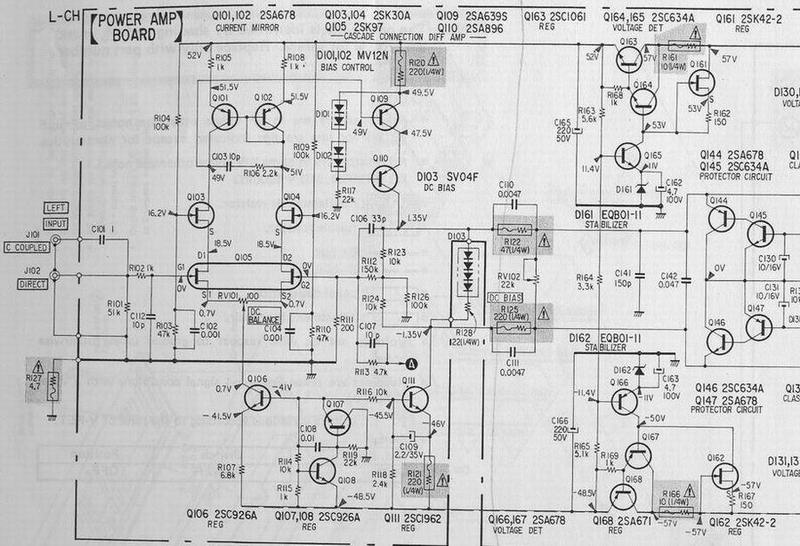

G.Kleinschmidt said:
Hey, does any generous soul around here have a web link to the TA-N7B’s schematic or a file to email me. I’m really curious to see this circuit.
Glen
These should be somewhere on the forum already, but what the heck 😉
Jan Didden
