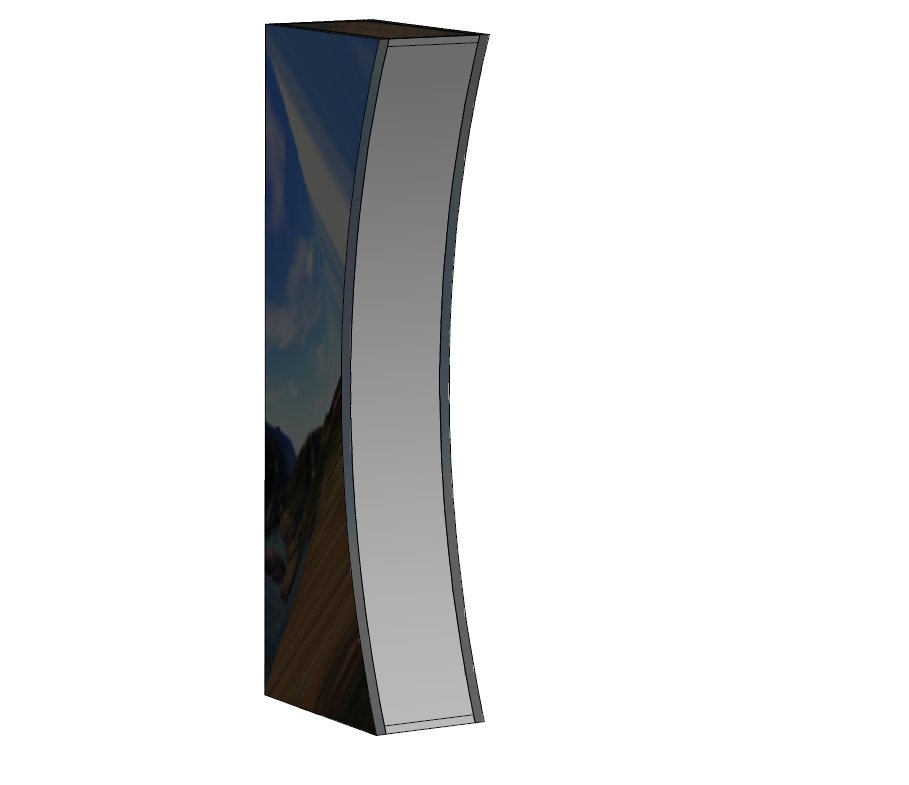

Jeff, yes, there's no reason why a version of this couldn't be done with a single flared vent rather than the doubled ones. The back-chamber would remain constant, it'd just need the vent retuning / sizing to work. I'll look into it when I get chance if you like. Greg is building to the v1.0 design. The v1.1 plans have a concave front designed for them by Ron, which loads the driver front & rear & provides an optimal wavefront -see attached render by Marce, (Marc, who only lives about 50 miles from where I'm based), who's planning on building a pair soon.

I was talking about the sides being 310, I should have said deep not wide.
I'm building a pair too, I'll start in about 2 weeks. The curved front put the WAF through the roof so they beat the Bruce.
I'll make it with chopped corners - no voids. I will need a leg or something at the back to stand it up which will be a good place to conceal the wiring and connector. I might even lean them back a bit. I want to join the top, diagonals, back and bottom all with 22.5 degree cuts so the wood matches up nicely at the 45 degree intersections.
I need to figure out how to make the horn flare for the backmounted tweeter. It's looking like an unpleasant couple of days with the rasp and sandpaper at this stage.

The Spawn range is going to come in for a bit of reorganising over the next month or so. These boxes are the direction the BVRs are now going in, though the legacy types will probably continue for those who like the aesthetics. I'll work on it when I get time. I need to get the dimensions over to Dave & Ron later today actually for the smaller two boxes.

I followed the dimensions put up by Scott and Dave on the original Chang plan, I used the sides at 310mm deep. Ron's idea of curve appeal is indeed an additional twist.
I am hopeful the Chang makes it into the family tree. Simplicity of the build is very attractive to start with.
