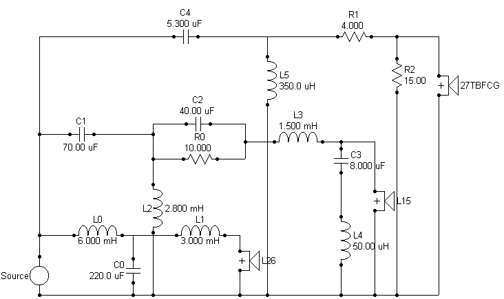

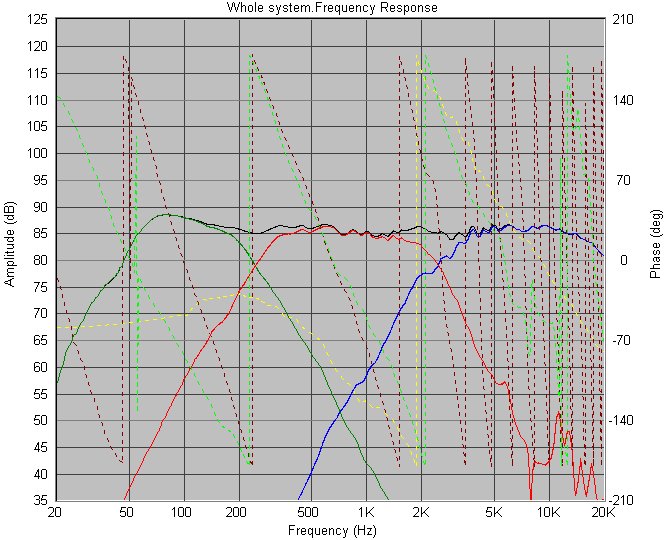

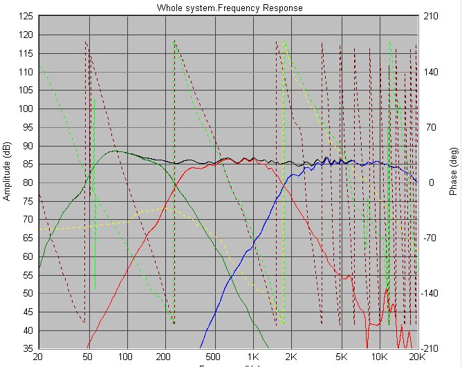

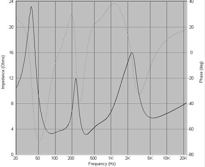

Here's a candidate crossover simulation and modeled on-axis (and reverse null) response.
Cavaets:
These are re-used driver measurements with simulated baffle diffraction added in
HBT generated phase using -1.018 and -7.677 inches for L15 and L26 offset respectively
SpeakerWorkshop used for crossover modeling
First the crossover:

I've aimed for 4th order acoustic slopes. Reason being - kill the resonances of the metal cone drivers - 4KHz and approx 8Khz for the L26 and L15 (respectively). Crossover points are 240Hz and 2400Hz.
I'd like to cross the L15 lower to the tweeter (say 2KHz) and eliminate as much 2nd / 3rd order distortion as possible.
Dave Bullet said:- normally all 3 drivers are in phase (which seems odd to me).
Hi, perfectly normal, not odd, for 4th order acoustic slopes, 🙂/sreten.
Thanks sreten. Good to know. I just haven't seen a 3-way where all 3 drivers are wired with the same polarity so assumed I must have done something wrong (well, I probably have somewhere!).
Although 14 components aren't bad for a passive 3 way crossover (esp. considering metal drivers are used and cone breakups must be dealt with), it will be expensive. I will try and rationalise it down. I'll also include a padding option of the upper mid / treble response for bright rooms.

Let say alot of cheap 3 ways are probably 2nd order acoustic slope... so that means 2nd driver out of phase. Also alot of exotic designs are built with as few crossover components as possible, because for that kind of designers, less is more.
2nd order = 180° out of phase, so reverse polarity on the center driver and it's back in phase.
4th order = 360° out of phase, but 360° = 0°, it's a full turn, so you're back in phase, all drivers need to have same polarity.

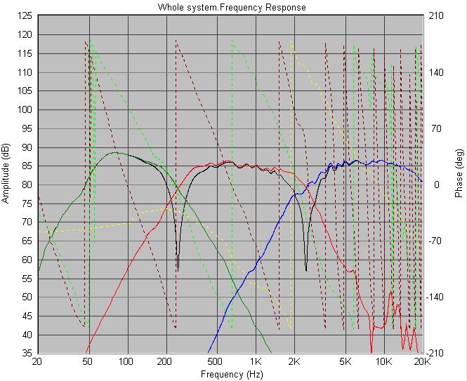

I really struggled with getting good phase tracking with 2nd order acoustic between woofer / mid (a bit beyond my design capabilities... ), so resorted to 4th order.
I will try again since I would like to minimise the parts count.

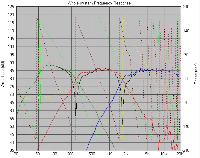

I wasn't happy with a 2.4KHz xo point with the L15. The breakup is 8KHz and I wanted to be 2 octaves clear of it.
I've modified the crossover and got a smoother response that has even better phase integration and brought the tweeter level down. However - I feel it might be a little too low now (1725Hz). Although 4th order acoustic has been maintained on the tweeter and it is only 5dB higher through the mid stopband than the previous version.

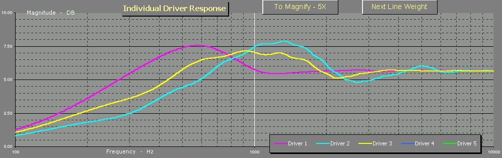

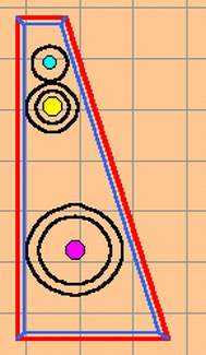

Here's the BDS geometry for the drivers.
My current enclosure plans:
L15 - large sealed (although EBP indicates vented might be better). I want to minimise midrange leakage out any port (by not having one). Problem with a sealed mid is backwave effects on the cone. I plan to mitigate this by a sloped internal divider (from the woofer cavity) to reflect the waves "up" and reasonable damping material. volume TBD
L26 - ported. Want to minimise excursion over a larger FR range. It's not about bass extension. I believe the 2 L26 sealed should get me into the 40's (in room). These aren't for HT / explosions.

Here's the BDS ripple.
Reason for the odd enclosure shape above:
a) smoother BDS
b) asthetics (not another boring rectangle)
c) imaging (narrower for the mid / tweeter)
I don't yet know how bad floor bounce / cancellation will be with the L26's so close to the floor. Might have to do some sim work on that too.
a) smoother BDS
Dave Bullet said:
..... However - I feel it might be a little too low now (1725Hz) .......
David.
Hi, see http://www.zaphaudio.com/BAMTM.html , 🙂/sreten.
