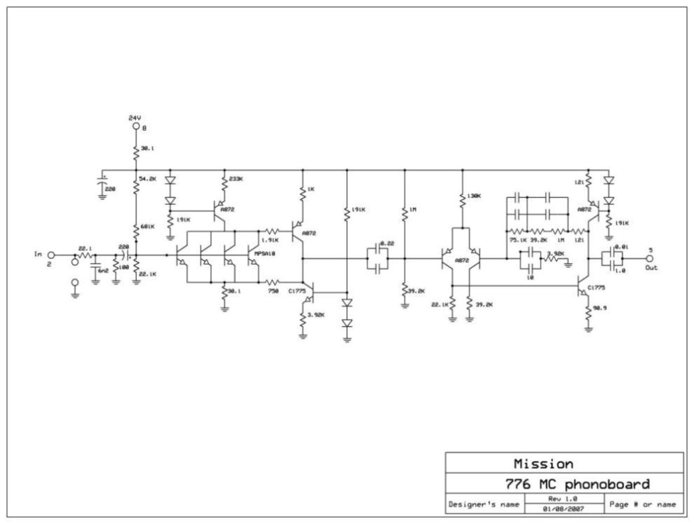

When I first examined the phono board and traced out the circuit I noticed the 220uF Tantalum used as the input coupling cap without any bypass. All other interstage coupling caps are bypassed. I read the original brochure for the 776/777 combo and it stressed the great pains they went through to minimize capacitor signature sound by using different brands and using bypass caps. The selection of passive component appears well thought out with 1% metal film resistors throughout. I don't know too much about that period of electronics (late 70's-early 80's). Were the tantalum caps thought to be "audiophile" caps at that time? It seem strange to me that they would have chosen the tantalum coupling cap unless they thought it sounded good.

Well I finally got around to working on the preamp. While I had it apart I decided to do a complete overhaul. I change the tantalum input cap to an electrolytic bypassed with a polypropolene cap and I changed all the coupling caps to polyprolene matching all the original cap values to within 2% of the original part. Surprising it didn't make that big of a difference. The most improved is the high end which is little clearer, more defined but certainly no earth shattering improvement. The power supply is a 24V battery filtered through 10000uF Elna, split into two supply lines and then separetly filtered by 2200uF Elna and bypasses by a Rifa 4.7uF polyester cap. How long are filter caps good for? This preamp is atleast 25 years old. Are the electrolytics worth changing if the preamp sounds fine?

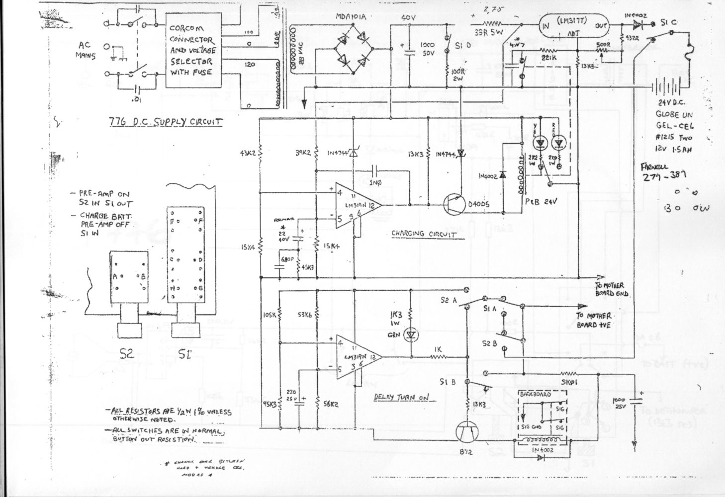

Schemetic for Mission 776
Dear, I also came across with a vintage Mission 776 Preamp, and could not resist to buy it!!!. The set is not in working condition, I tried to search the net for its Schemetic and luckily found that you have it. Is there any possibility to get its Schemetic from you through the net?. Regards. h2o
Do you know what version you have? They come in MC or MM only phono. They are pretty robust units. Battery failure is probably the most common problem.
Thank you for replying. The unit doesnt say any thing, the BALANCE control at the back is not installed by the manufacturer, I guess it is MC. It is made in Canada with high grade components. Probably, I only require Schemetic of the charging circuit board where two ICs made by Philips # LM319N are available, especially I need the two main transisters numbers. The present numbers are not eligible. I am in Karachi Pakistan, thank you once again. Regards.

There was a provision for a balance control on the 776 but it was never implemented in the production models. Mine has the exact same missing balance control as does all the other 776's that I have seen. There is a mono button which ties the two channels together at the input to the high level board but no balance control.

I drew out a schematic when I updated the components on the mother and daughter boards so that I would have a record. I am not sure where any official records still exist. The units were built in Mission's Rexdale plant in Ontario in the early 80's.

Dear, I have mailed you earlier requesting for schemetic of Mission 776. I attached 12Vx2 fully charged batteries with it but RED light is constantly remains on. The set does not go to PLay mode. The Diagram of indicators at the top cover is also not legible and rusty, though I tried to clean it but no success. Do I expect any help from you, please?. Regards, h2o
