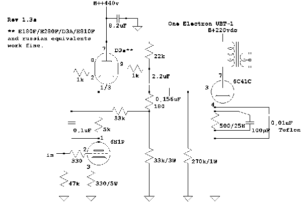

Hi all, I was wondering if you could give me some pointers or background on using batteries for biasing my driver stage 6n1p.
I bought the same batteries Gary Pimm uses for his battery biased CCS (CR1225FV / Lithium 3V)
I want to try them on my design instead of the 330 ohm resistor. See schematic.
The voltage across the cathode resistors is 2,6V now. That means around 7,9mA running through the 6n1p.

It'll mean the stage gain will go up a bit, because at the moment you have an unbypassed cathode resistor.
I don't know if there will be any sonic benefits. This valve has such a low Ra, and with the active load....
But it's worth a try...

The circuit shown in the picture is a mu-stage. Be careful with battery biasing there bacause the bias point is set by the upper penthode. It's a fixed current system instead of fixed voltage. In a mu-stage you won't find much difference in gain if you bypass the triode's cathode resistor or not because of the anode load (the penthode) wich is very high compared to the triode's cathode resistor.
Battery bias works just fine in anode follower or choke/transformer loaded circuits wich are actually fixed voltage systems. Tubes really like it if you run them in a fixed quiesent current or in a fixed cathode voltage, you can't do both, one factor has to vary with the grid voltage otherwise it's not an amplifier anymore.

You are soo right, about this. I tried bypassing this morning with a capacitor. I could hardly hear a change in volume. It did sound different though. Maybe even better...
What I don't understand though is...the mu-follower determines the current.....so why do we need a cathode resistor at all?

Mu-followers work very well with fixed bias on the lower valve, whether it is battery bias (on grid or cathode), diode bias (cathode), or a PSU to supply grid bias. The gain doesn't change from unbypassed resistive bias, but the power supply noise rejection improves...

Hi bas, you still need a cathode resistor.
Normaly you set the bias current with the cathode resistor by a given anode voltage. Lets say that the upper penthode is a true constant current source. The bias current is then set by this current source. The cathode resistor of the triode now doesn't set the current anymore but it sets the amount of voltage on the anode of the triode.

I read Allan Kimmel again. The bypass cap does indeed not increase gain but does however lower output impedance

Bas, then "Allan Kimmel" is wrong. Bypassing the cathode resistor DOES increase gain, because the tube is no longer subject to degenerative effects - ie. negative feedback from the AC signal presented to Rk.

Actually Alan Kimmel's verbatim words were :
"This will have minimal effect on the gain"
I tried this and he is right. Don't forget it is a Mu-Follower.

Bas, I'm sorry - I didn't see that this was a mu follower!
I was referring to a standard common cathode voltage amp.

I must admit that I was uneasy when I posted my comment about the gain increase with added cathode bypass cap on this circuit, but actually it is by practical experience.
Perhaps this means that my mu stage is not working right? I'll have to invesigate this further.

Having built some of these circuits, I can say that in fact adding a bypass cap shouldn't change the gain of the mu-follower at all.
Could it be you made the calculations for your stage with a bypass cap in place?
