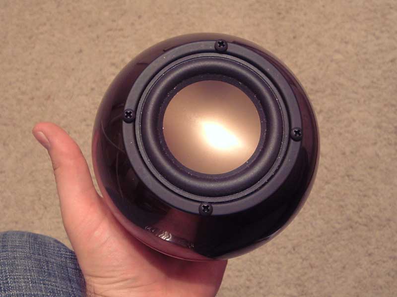

Thanks. They're amazingly easy to make, and look good as well (and cheap!). I think the sound is great. Although the enclosure has a Q of about 1.4. I'm not using any BSC yet, just Zaphs notch filter. I'm crossing them at 120hz LR4. I havn't had distortion issues yet at moderate volumes.
Dr.EM said:Nice work there. Presumably the idea is to reduce baffle step effects in a design like this? How is the sound?
Bowling balls are some kind of resin. I expect its extremely tough but perhaps a lathe would be capable of hollowing one out 😕

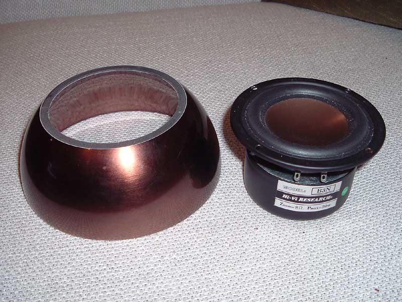

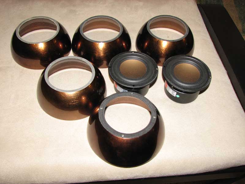

They are hemispherical bowls I came upon at Target. Unfortunantly I cant find them on thier website. I simply chopped the end off to accomodate the driver. For me this was especially easy as I used a CNC mill. To join them, I made a press fit ring out of 1/2" MDF and glued them together. The bowls are only 1/8" polymer. However due to the inherant strength of spheres, the orbs are probably more solid then the 1/2" MDF test boxes I made. They do seem to vibrate less. For wire connection, I deconstucted these inexpensive terminals http://www.partsexpress.com/pe/showdetl.cfm?&Partnumber=260-301 for the posts. All that is needed is a pair of holes to be drilled and the posts can be put through and tightened down. My one and only concern is the finish on these bowls is not durable in the least. In the future I may want to sand and paint them. I'll have to see how well they hold up over time. But for $2.99 each i'm not complaining either way 😀
