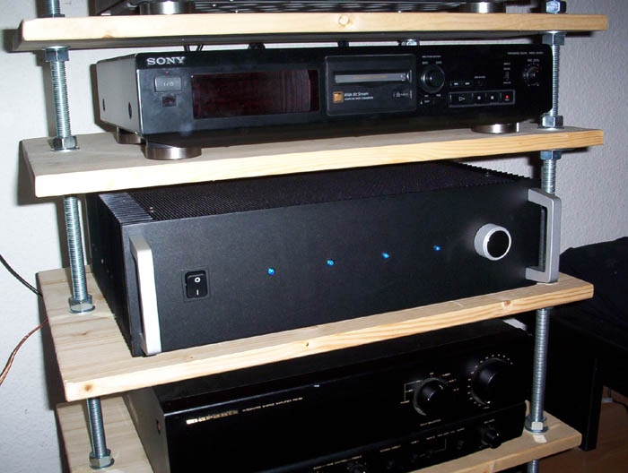

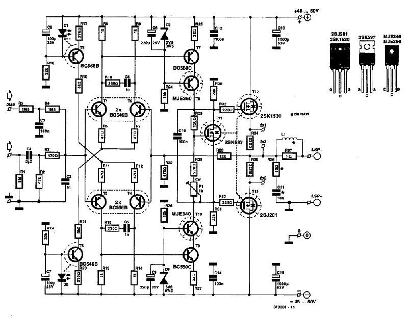

Hi all,
just am about to finish my actual project: a crescendo ME.
The sound is astoundingly good->I´m happy
BUT : Turning on the oscilloscope for some final checks made me
At +-47 supply voltage the output swings at +-30V (25RMS).
Input signal was a sine wave of 1VRMS and it doesn´t matter if the output is loaded or not. It starts clipping at 25RMS in both channels BTW ...
I´m using a 10kOhm pot as passive preamp at the moment.
Input impedance of the amp is 45kOhms.
Could this cause any problems? Should I maybe match the pot more to the input impedance ? (like 50k)
Another point probably causing problems is that I took 1.3W zeners (D3,4) instead of 0.5W so they might be not biased enough.
Power supply is 2*35VAC/600VA , 2*33000uF for both channels.
Bias is set at 300mA.
I´d appreciate any hints cause I love this amplifier and want to have the last watts as well!
Thanks in anticipation

Jens,
It is normal to give up 10-12V of headroom with this kind of
circuit, so you should be getting about 35V peak (25RMS) from
the amp. Could your 'scope be wrong?

Hi Jens,
yes it is normal to loose 10..12Volts with this circuit, roughly speaking you loose the gate voltage of a FET and the voltage of the zener in the second stage (I can´t figure out the number on my monitor...)
So you loose 5V more than expected. I think you should check
1. if the zener has the wrong voltage
2. if the second stage is biased wrong. Current should be somewhere around 40mA (if I didn´t misread values or made other mistakes), and if it is significantly lower (around 13mA my guess...) than you have the problem. You can take out R30/R31 to see if the clipping gets away (may get unstable though), because at 30 V they will take up all the current (if it´s 13mA) and the voltage cannot go higher. So my guess - wrong bias (check LED´s).
Hope this helps

Hi Jens,
30 or even 35 volts is a little low. I get 24.5 volt RMS with a 42 volt supply so I´m loosing not as much as you do (it´s the older design with 2sj50/2sk135 though).
One thing you can do is to make a seperate supply for the driver and input stage about 4 to 5 volts higher (so 50-52 volts). This will give you a bit more efficiency and better sound quality.

Over D3 and D4 I measured 2V if I remember correctly.
(I can´t stop listening to the amplifier so it goes from the workbench directly back into the rack ;-))
These diodes are rated 3.9V/1.3W but I´ll exchange them as soon as possible to 0.5W for proper bias.
The LED´s are properly thermally coupled as given in the schematic but I´ll check them for correct bias.

Uups, how confusing of myself! 😕As i don´t really need the full power anyway I think I can live with it at the moment.
I was relating to Williams tweak of course and still want my amp to work properly.
Measured the voltage over the zeners D3 & D4 (3.9V/1.3W) again and got 2.8V.
Shouldn´t it be like 3.9V to have constant value or is it just a limiter to not exceed the 3.9V?
Jens
Hello Jens,
yes it should be 3.9V all of the time. Are you shure you´ve got enough current flowing through them? Try changing the resistor feeding them to get a constant value (lower it´s value by a factor 2 or so)
william
R24 and R25 5k6 should do the job.

wuffwaff said:Hello Jens,
william
Changed the resistors to 6k and voltage over the zeners is 3.0V.
Getting an old book about electronics out it says a zener has to be biased with 0,1*Imax. In case of my 3,9V/1,3W zener diode this comes up to Ptot/3.9V*0,1~30mA which is a lot for the resistor to cope with at 42V and nonsense anyway so I´ll definitely go for a 0,5W diode which should be happy with about 12mA current.
Jens
back here to update the amplifier lacking output power.
Changed the D3,4 Zeners to 0.4W types and now the bias current of those is high enough so they give a proper 3.9V.
Output voltage of the amp rised to about 27VRMS which gives a good 90W. Yippie!
The treble response of the amp got much better with that change so it had to do with the failure as well.
For those who are interested and need some measurements of the crescendo ME design here the quote of Elektor´s email:
Thank you so much for all the help and ideas.
Jens - listening to his amp until he has to eat something
Hello,
Some measurements:
Related to ground or over resistor:
(0 V =< 10 mV, all measurements +/- 10 %)
R3: 0 V; R17,R20: 1,05 V; R8,R9,R13,R14: 1,9 V; between R8 - R9 (R13 - R14):
< 100 mV; R25,R27: 1V17; Gate T12 - Gate T13: 4 V; R34,R35 : 50 mV
(quiescent current somewhat higher); Tp3: 0 V, Bias : < +/- 10 V
The peak output voltage should be around 38 V for 90 W in an 8 ohm load. So
there might be some thing wrong. The gate-source voltage in the output stage
and the setting of T7/T9 and T8/T10 is the cause for a 10 V drive loss.
This is inherent to the design.
Ton Giesberts
