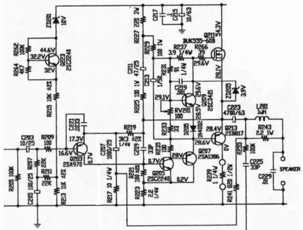

Those Fets we can find inside damaged PC supplies
So...there's no complicated thing to find or to buy, nothing hard to find or parts we do not use to have in our junk box.
Needing a better schematic...if no one post the one you want.. come to my mail adress informing yours and i will upload you bigger schematic (bigger data)
panzertoo@yahoo.com
regards,
Carlos

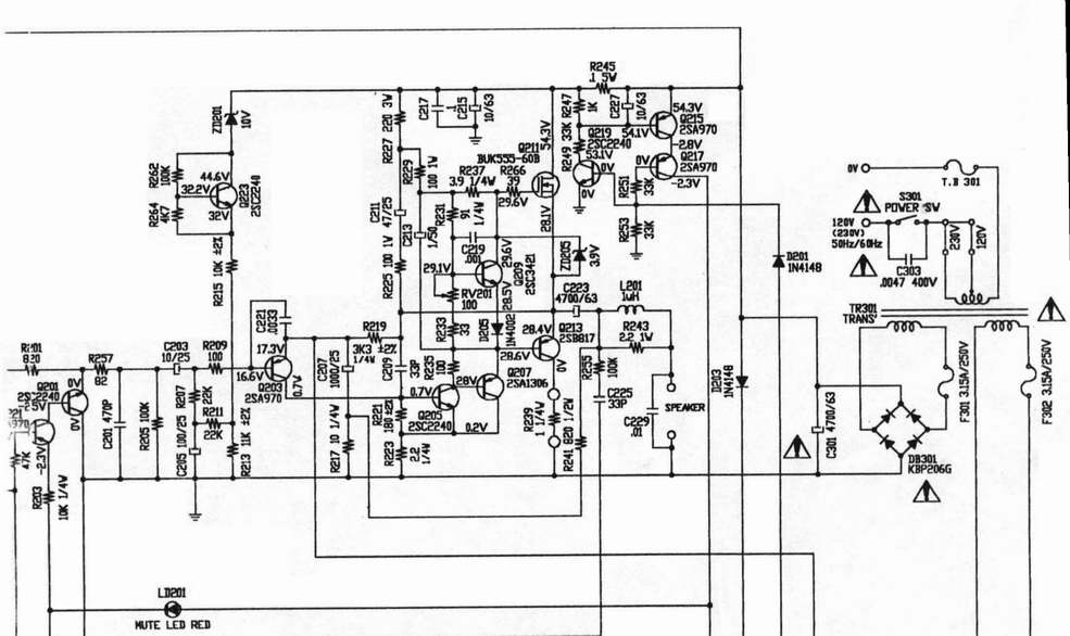

Here is a more simplified schematic...the Model 310
Yes... i hope a forum friend will post the one you want...if not... i am already offering you another option for your analisis.
regards,
Carlos

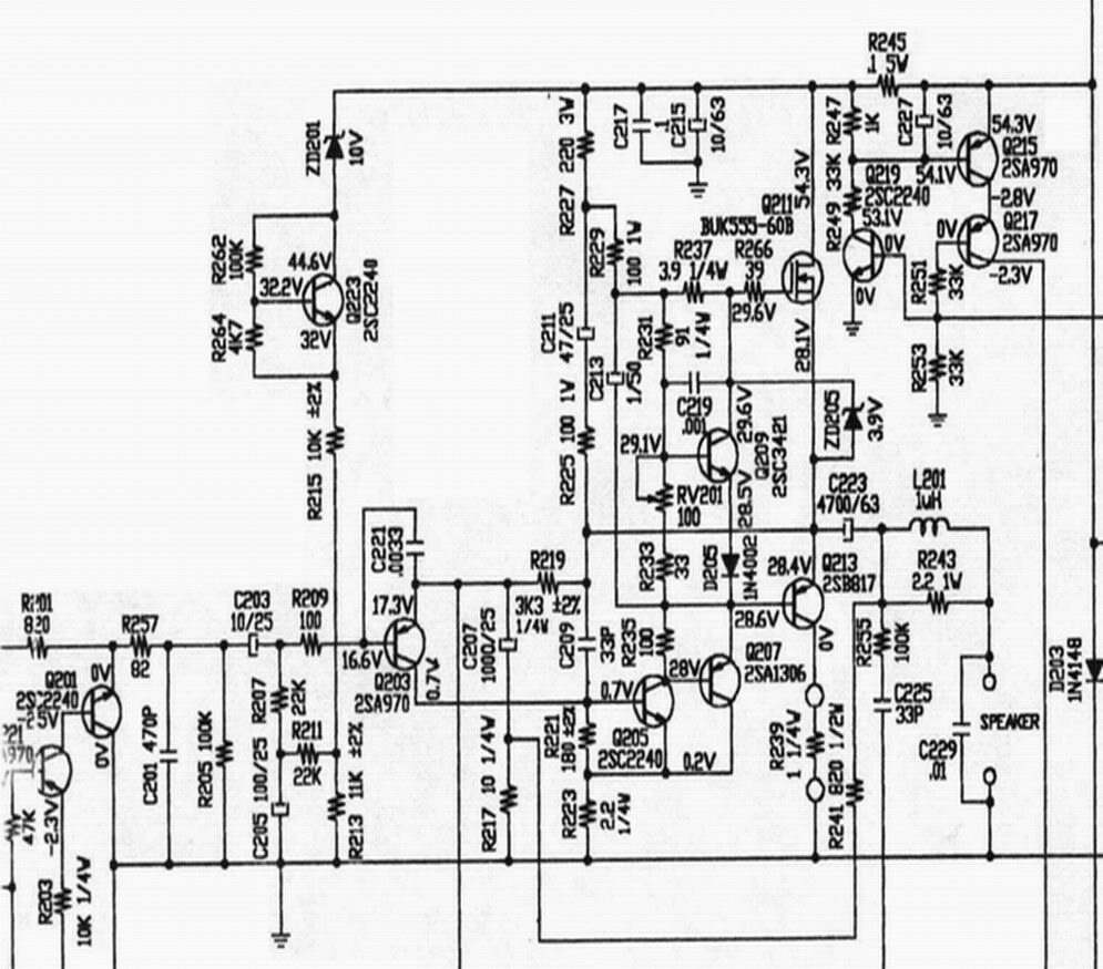

IsakAlexander said:
Hi IsakAlexander.
Thank you for posting this.
Is the schematic or manual telling what exactly the iddelcurrent has to be by measuring voltage op TP 301 303 302 304???
Iddle current setting with VR301 (VR302) voltage measuring over testpoints TP301 and tp 303 (TP 302 and TP 304)
Does it perhaps tell something to put the finals more in class A ??
Best regards.
Onno

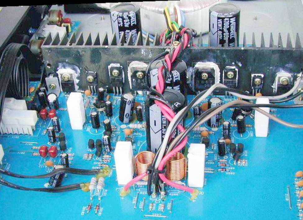

Still after putting in new transistors: MJL3281&complementary I cant get this thing to work.. Fuses dont blow, relays dont turn on and left channel have 1132mV on the speakerterminal.
Anybody have a suggestion to what the h#ll is going on? My guess is somewere on the mainboard, bad soldering, faulty diode or some minor thing. :bawling:
The right channel only gives very low sound when full input and forced the relay.
Yes I did measure the drivers and other small ones at the left channel print.
I do belive the fault must be somewhere at the main print, the power section and have read that this model have had rectifier problems. When forcing the relay no sound are outputted, only small dc current. Right channel outputs sound when manually forcing the relay but its very very low even on full input from a cd player.
Could it even be the input section are damaged(op amps), thus making dc on one channel and nothing at the other?
Hi Isak
Did you check on point VR1 there is 82 volts dc !
if not check R 702 and 704 (both 100 ohm).
(on the main (power) print)
second check goes transistor Q 707 open (mute) via
R725 ( 1 megohm) ?
And are both channels not working ? or only one channel ?
Onno
This is what I got:
Between J317 and J321= 145V dc
J319 and J321= 72V dc.
Same value on the other channel, are these the wrong values?
Adjusting the pot`s on either the pre or output print does not change anything.
The resistors R704 and other 100ohm value are all ok.
