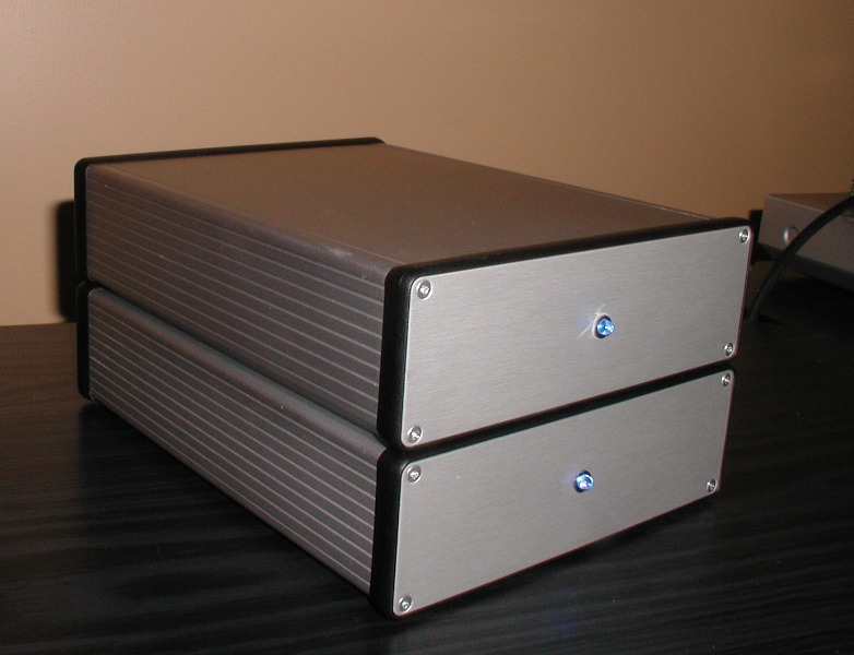

I built a 12 chip DDDAC a little while ago, its been sitting naked on the shelf while I decided what to do with it case wise.
While looking for a case for my compact chip amp I came accross the hammond 1455 enclosures.
These extruded cases have internal grooves to hold circuit boards, which by happy coincidence hold a DDDAC board perfectly...
A plan was born....
Here is what I came up with
The case although width wise is right is not available with the correct height for a DDDAC module. However in the larger widths it has a slide off panel. This I took a drill, junior saw and a set of miniture files to to "open up the bonnet" 50's Hot Rod style.
I fashioned holes the right size and shape for the DAC's cooling tower.
From light alu sheet I cut and brushed a strip which folded makes a vanity screen/shield for my chips. I am going to work on the shape of this further.

I will be shortly upgrading from 1 DAC module to 3. The case has space and I think will look cool.
I will have a set of stepped cooling towers, increasing in height from front to back..

john65b said:You don't like the Black plastic bezel? I prefer the enclosures with a bezel.
Too bad the largest of these perfect model 1455 is only 8" x 6".
A pic of the 1455 - UCD180 Monoblock. Too bad I sold her off to build a UCD400...too pretty.
I hummed and hawed a bit before deciding to go without the bezel. I wont throw them out in case I change my mind. 🙂
I agree its a very pretty little case. I dont do imperial, but for those that are bi-lingual, the case I used is 220mm by 100mm 8" x 4" (I think)
Its very neat in size. This will hold a 120VA torroid.
