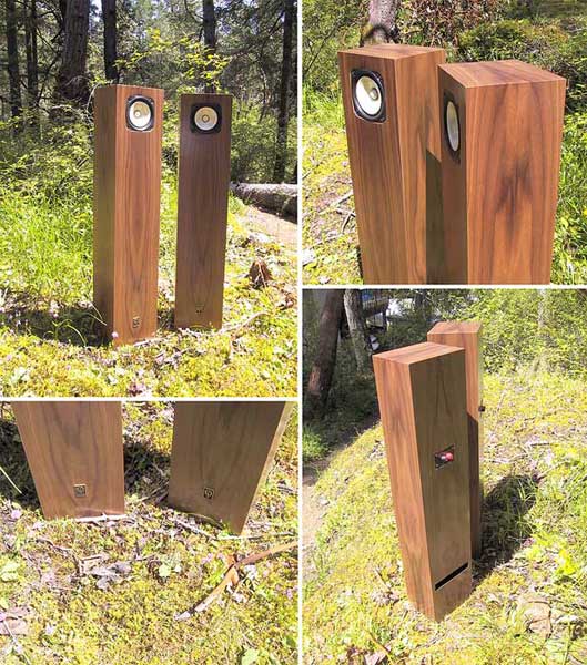

You don't realize how small these are until you stand next to them... 12mm material is fine... Chris & i sort of decided to standardize on 15mm for most everything so we could justify buying a lift at a time (and then they ran out of 15 for a bit) So we are now working thru a lift of 12.
Here is a picture of the original build of these for inspiration, now residing in NY, NY
dave
dave
Scottmoose said:Now for speakers, especially floorstanders, those are cute.
and compared to the "classic" Fonken, almost any member of this or the MLVoigt family are an easy build.
what this set of pictures doesn't fully reveal is the nice wrap-around grain matching the small enclosure size allowed
