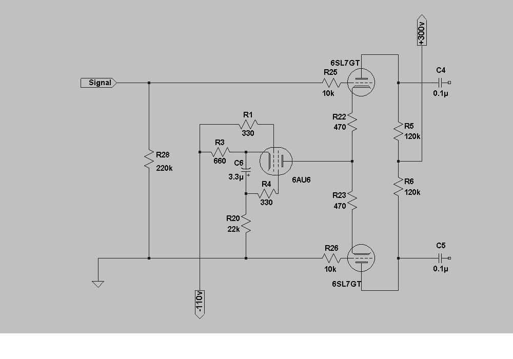

Since you ask for schematics, attached is the very simple but effective 6AU6 current sink I use in the LTP splitter of my amp.
:bigeyes: uh oh,
don't tell me 'cause it hurts...
Is it right that I definitely need a negative rail for the CCS... As I'm planning tube rectification, this means another Transformer winding, rectifier tube, heater winding and filtering *sniff*
This amp grows bigger and bigger... :xeye:
Andreas
Ex-Moderator
Joined 2004
It's generally easier to have a separate negative supply but you don't actually need it if the cathodes of the LTP are at a sufficiently high positive voltage for the pentode to operate. For a 6AU6 I wouldn't go below 100v, especially if you neded a higher current than about 2 or 3 mA.
It would probably work without a negative supply, for instance, if you had a Mullard-type circuit with a single-ended input stage directly coupled to the LTP. Then, you would need to drive the screen from the B+ rail, through a suitable resistor. Ensure the screen to cathode voltrage is no higher than the plate to cathode voltage.
A negative supply is easy enough to fix up if your power transformer has a centre-tapped secondary for the HT and you're using full-wave rectification with the CT as ground, instead of a bridge (which is also full-wave, of course, but that's the terminology). Then you can connect a pair of silicon diodes off the same HT secondary, in reversed polarity, to get the negative line. If the voltage would be too high, an old trick is to use capacitors in series with the diodes as wattless droppers.
Although you're using tube rectifiers fior your B+, it's pointless using tube rectifiers for the negative rail as well. SS diodes will OK for the negative supply, especially if you want to use it also as a source of negative bias for the OP tube grids. That will ensure that the negative rail is up before the positive rail, so the OP tubes are safely biased .
