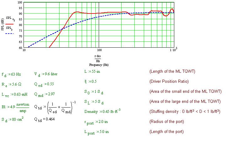

I've included some sims, depth is going to be restricted, so line
the cabinet - i'd recommend significant depth on the back and
one sidewall, add stuffing to the top half. Put the port on the
back ~ 1/4 to of the way up.
If you want the port on the bottom I'd suggest asking for some
MJK type sims of whats going on - its a sort of ML(T)QWT.
These sims may suggest a larger box and different vent size.
They may suggest a TL could be a better option.
Of which there are plenty of variations.
/sreten.

I put the numbers into MJKs program and came up with a fairly good response which will produce a similar sized cabinet.
